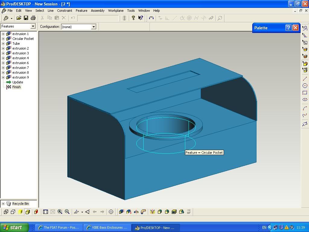

i have designed a sub enclosure (1st design) that i want covering the back seat backrests so these will be coming out what do you think?
the front will be covered by perspex or something similar and will have a port in the top, and reccomendations on what to tune this to?
heres a cad design
Has the bandpass been designed to any specification then. If the sub recomends 2.5k then i would put no less than 3K through it :D.
Your looking at a pretty hefty amp there and im guessing that you need at least 6/7cu ft of airspace for a sub which is designed for SPL not music.
What car do you have and do you mean that you are taking out the back seats in the car.
Tell me if im being patronising but are you a seasoned audio installer trying to build an SPL system, have you looked at the TS parameters and looked at every order of bandpass available.
Im am by no means an expert but that 4th order doesnt look right. The sub should be inverted firing down into the ported chamber (at the side so your not firing air straight out of the port) at the bottom leaving the top chamber sealed.
so you mean have the port on the side and not the top?
yeah just been looking at 4th order bandpass n i designed it wrong :p
4.5 cu.ft of air, so ive designed the sub box to be, W 40" X H 10.8" X D 21" which gives 4.5261cu.ft of air. its 40" wide to cover the area where the backrests would have been.

Those dimensions work out at 3.0065cu ft internal before displacements.
Do your dimensions include the chamber as well :confused:.
You need 4" between the port and any other surface.
those dimensions were a quick thing to see what size of box it would be, it does not include the chamber no... i decided on a 4th order after:)
