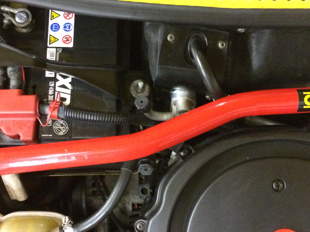

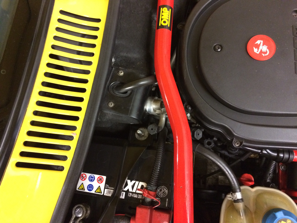

Hopefully may give U answer. Depend is a Sei SPI or MPI? I got an MPI A/C and I bought an OMP one which I think isn't really suitable coos at the beginning air filter box was touching to brace when engine was running and when I solve the problem than was up the bonnet.
Still U'll see on Yours.

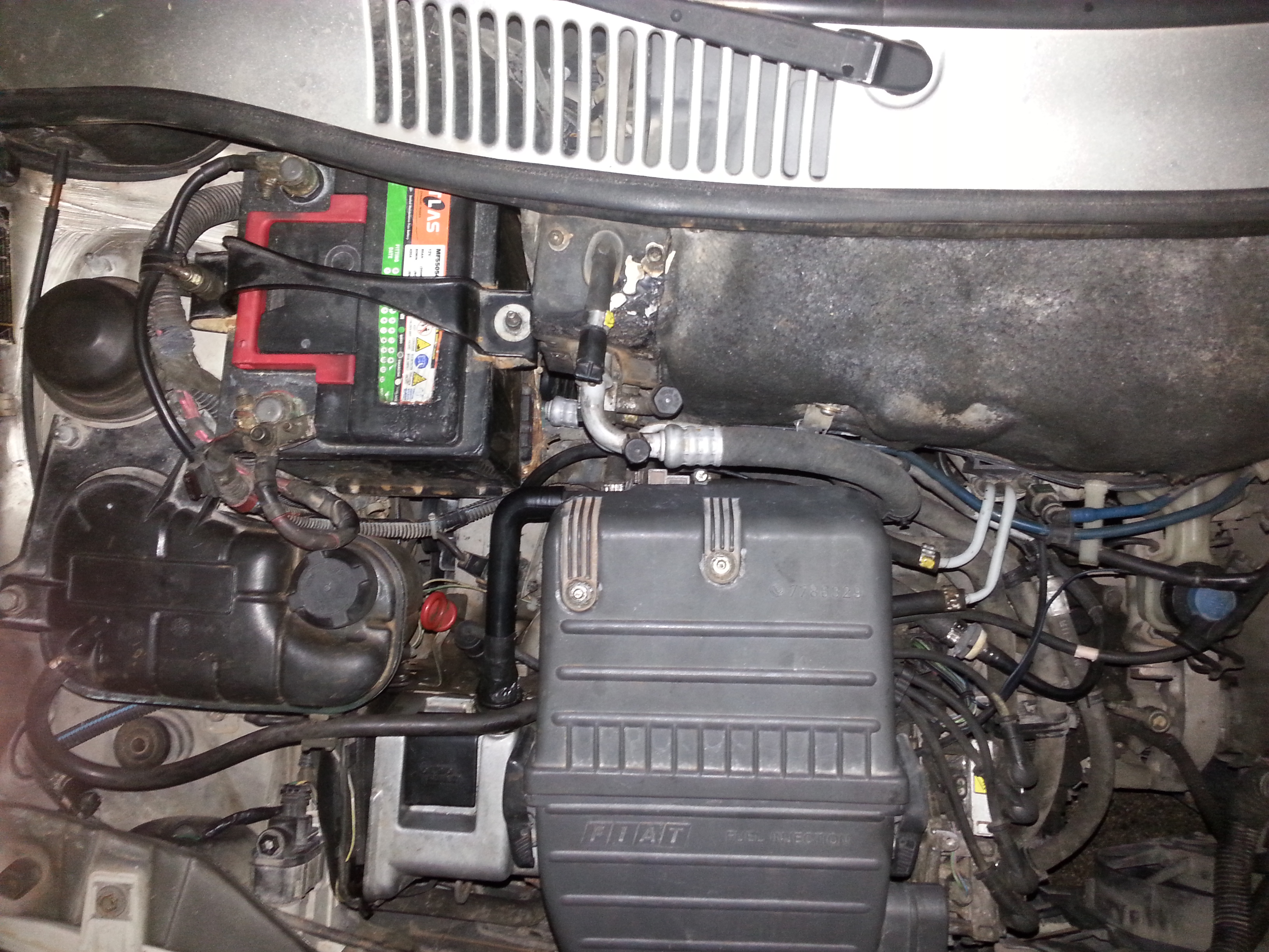

Spi engine but i will change the intake with Dexcraft.

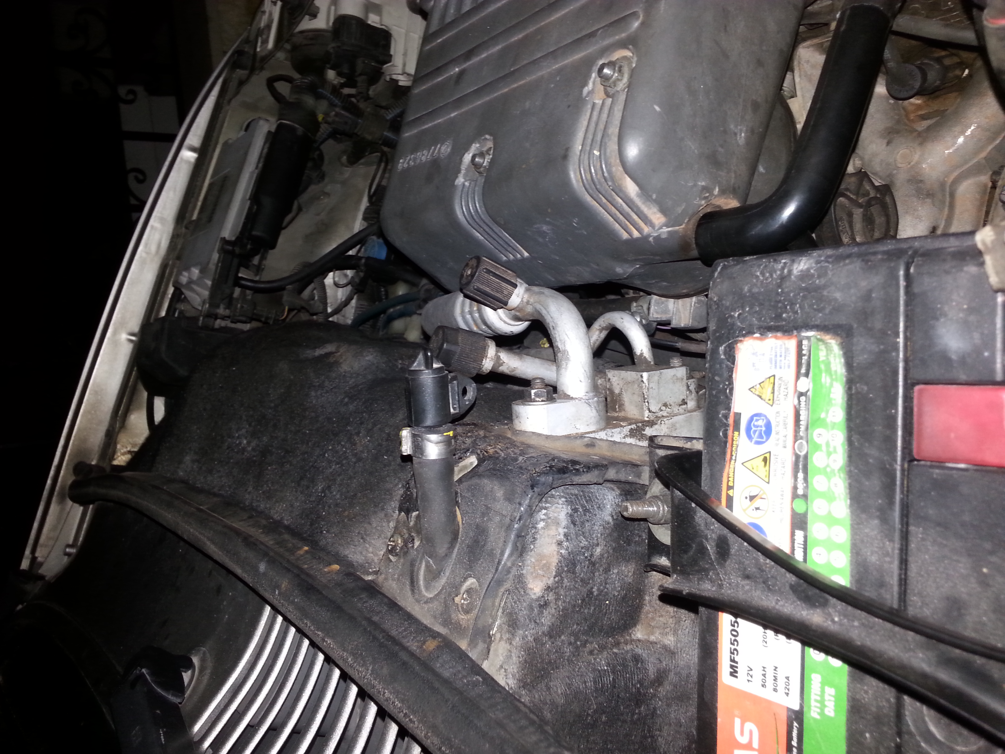

Some photos to watch the ac tubes coming out.
Ouby i speak for the upper one not the lower.

I understand that I have a spi engine i ask because there are the metallic tubes coming out as you can see in the photos i post.

Best bet will be if U ask seller about. I've had same worries but about it. OMP on MPI fits without any problems but U wanna buy different make 4 U're SPI so if doesn't fit when U receive it than U should be able to send it back?
Looks if U don't try than not gonna know???
By my opinion it will fits without touching AC pipes.
This is my one.
