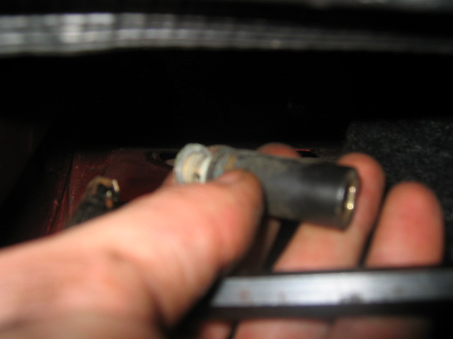

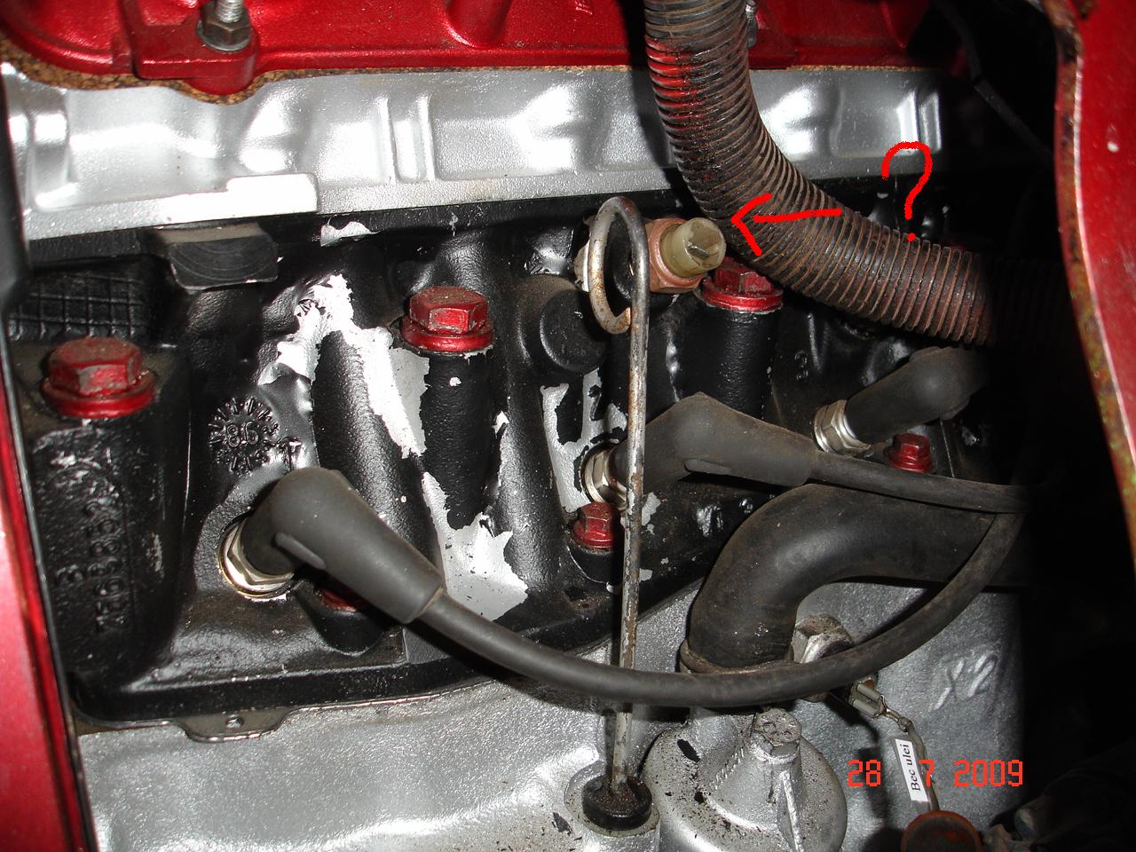

Please help me to figure out what this bulbs/sensors are doing .
here is the first one :
attachment.php
a closer look :
attachment.php

thank you for your answer, however, photo 1 and photo 2 are showing the same connector/sensor .... photo 3 is different, can you be more specific ? water temp is not moving on the clocks no matter where i connect the wire ( i have 2 set of clocks, all act same way )

Yes, the first one (pictures one and two) is a coolant temperature sensor for the fuel injection ECU.
The second one (picture three) is the sender for the temperature gauge.
Although the two senders measure the same thing (temperature of the cooling system) they are separate systems and the wiring must not be mixed up.
There is actually a third sender on the radiator itself - that is for turning on the radiator fan.

The coolant sensor for the EFI is not original uno turbo sensor. lets hope it does the same job. If not the engine will run bad.
-Alex

I thought so, thanks for confirming that!
Original temp sensor would have a blue plastic wire-clip-type plug integrated with the sensor.
-Alex
on the other side of the water pump there is a sensor with a blue connector .....

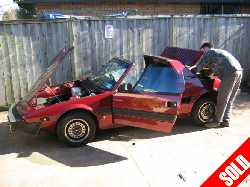

The drain plugs are fitted to the coolant pipes under the front floor (see second picture). I owned this fairly tidy '88 X1/9 for about a year but sold it in 2006 ;)
