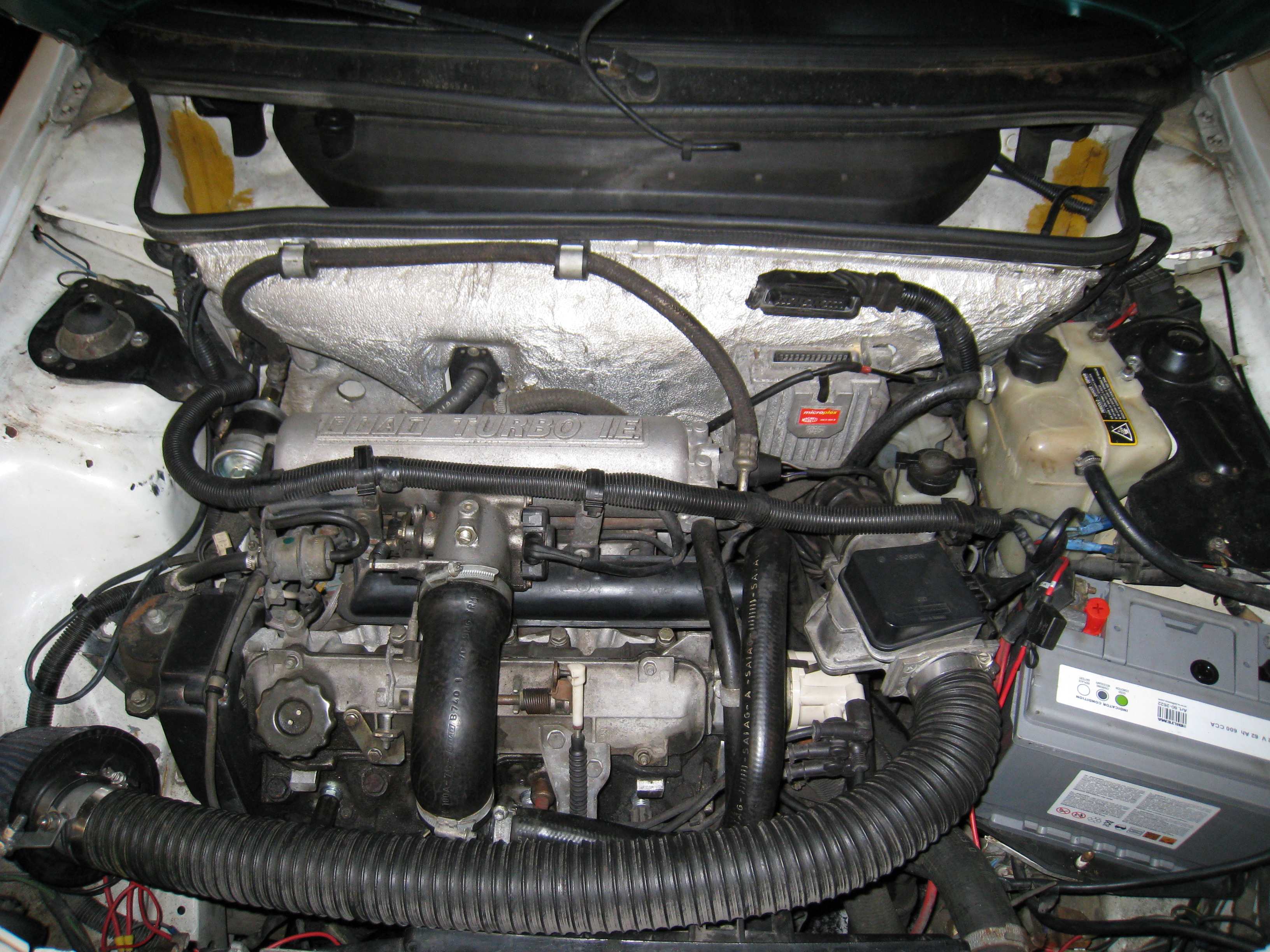

Hi, I was out driving the other day then suddenly the engine just lost all power and the hole car was "jumping" when i pushed the throttle.
I've had some idle problems, running at 1500-2000rpm. But now the car would not run at all. Well, i can fire it up but cant drive and have to constantly push the throttle.
Any ideas what could be wrong ?
1988 Uno Turbo
have a look at the tdc sensor cable, ensure it hasn't got snagged or burnt out on the exhaust, get similair running with that. the other thing was if you have a non standard air filter stuck on the afm, i couldn't figure why the white one was so jumpy on full throttle, till i took the filter off, and found it had a square cut hole...over a round entry:bang:
Allright, i got a K/N filter, but i it seems fine. I gonna go out and have a look on the tdc sensor cable soon. :eek:

I think Jai is right about the sensor for a non-run situation, but judging from that video, it seems to be running - so my guess is that you just have an air leak into the intake system. It sounds lean to me at 2000RPM and it is too lean to run below 1000. There are lots and LOTS of places for this air leak to occur :(
Have you noticed any odd squeaks/whistles/raspberry sounds? If so, check in particular the small short pipe that connects the turbo to the metal pipe over the gearbox. Then check the intercooler (plastic tanks may have split), and the boost hose above the cam cover. A leak at any of these points will make on-boost noises and also affect the idling (when there is high manifold vacuum).
If there haven't been any odd noises, then it is more likely to be a leak in the small rubber pipe that runs to the Digiplex ECU and the boost gauge (T-junction), or a leak in the brake servo pipe, or a leaking recirculating dump valve (VERY likely with the plastic original - has there been an on-off-throttle jerk before?)
The final possibility is that there isn't a leak at all - and instead the Idle Air Valve (a reliable Bosch device) may have given up. This is bolted to the front of the cylinder head, near the gearbox. Try blocking off its pipes. The idle speed should be lower than with the valve in the system, assuming that the engine is cold. I'm fairly certain you have a leak though, because the engine sounds lean at 2000+ RPM.
