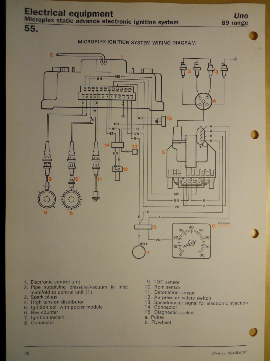

I would use the engine speed sensor on the flywheel, given what Apexi have told you. The wires terminate at the ECU on pins 3 and 16. This is all in the Haynes manual you have. Don't know if it will work of course.

Going back to the engine speed sensor, as long as its a negative signal thats outputing around 0-8 volts that varies with the RPM, i guess either pin would work? :idea:
