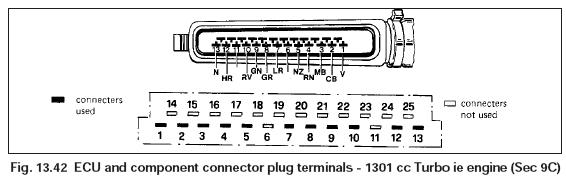

It's pin nr 22 on the ecu.
I don;t have the manual. Could you just make a picture of the ecu and of the pins there, and point the pin it should be connected to the turbo instrument panel ?
Thanks !
apparently its pin 22, but which wire it goes to on the digital dash is another thing,
I've attached a picture of the ecu for you, if you do get the digital boost to work will you please post up details for others so we all know how to do it.
