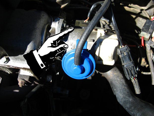

can someone please point on the pic where is that module? just in case my uno stops working in the middle of traffic :) is it maybe a small black box behind the batery with a cable that goes to the distributor?
Here you go!
Its on the "back" of the distributor.

Yep, Ucof pointed that right, Kozmos. It has "radiator" attached for cooling, (exactly like PC proccesors do).
I find it really strange that it's placed behind, not in front of the distributor.
It'd have much better cooling there :eek:.

thank you for the answer, and no it's not my uno :) just found a pic on the net for an example.
