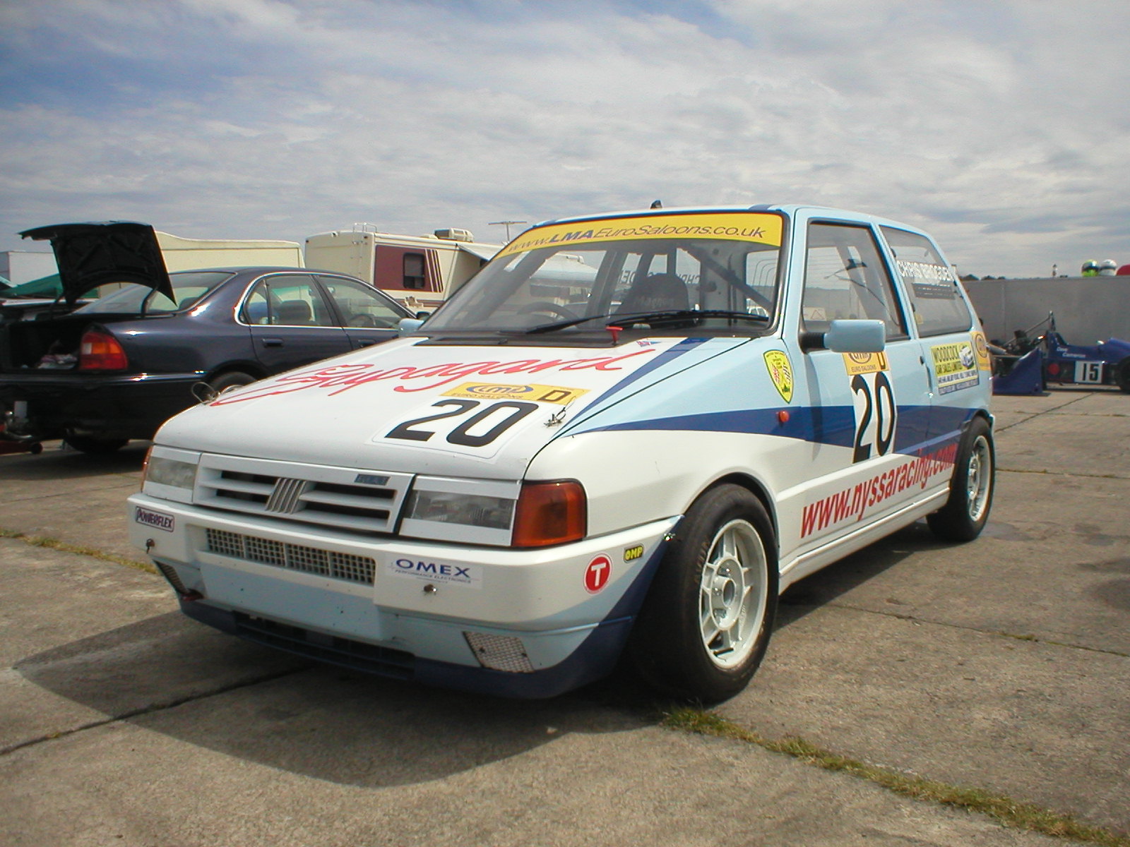

Ah ha, think I have learnt how to post pics lol, this is my little beauty!

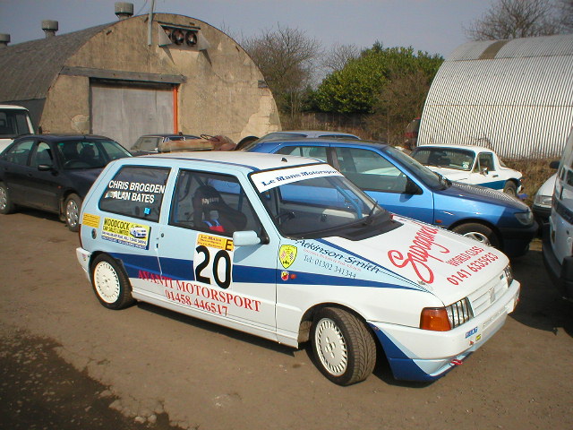

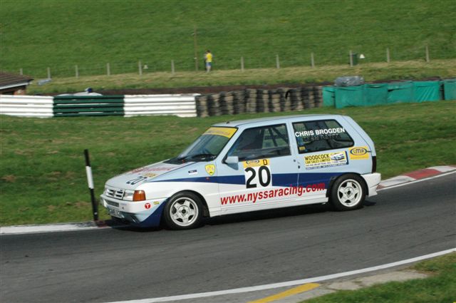

A few more pics as requested. I am currently painting/improving interior of the race car, and will post a few more pics as I get them. Engine build has been a slow process, but hopefully I will be racing at Anglesey on 19th and 20th August, providing it is up and running! Uno turbo is a blast to drive, if not a little too stiff on suspension. I may have to put some softer springs on me thinks!

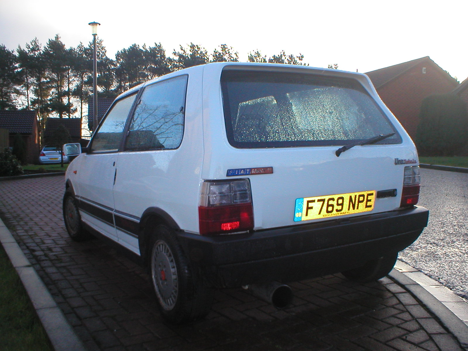

Uno turbo
I may be tempted to sell the uno turbo if anyone wants a nice one, as my race car is costing an arm and a leg to develop. It has done 103.000 miles, and had been dry stored for more than 5 years just before I bought it. It has had an awful lot of parts renewed, and has a very healthy/powerful engine, which does not burn oil/smoke etc. It does need some very minor finishing touches, such as rear wiper motor fixing/replacing ( I have a spare), rear washer pipe connecting. I want £1950 for it, and it has cost probably twice that to bring it up to the standard it is today. Bodywork is unbelievably good condition, only having paint on rear quarters due to minor scrapes.
