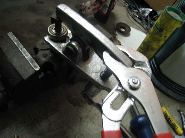

The hardest part of removing the lower arm is probably splitting the balljoint (I use a clothes-peg splitter for this - see https://www.fiatforum.com/attachment.php?attachmentid=46418&d=1215506407 where I'm using the same tool for something else).
