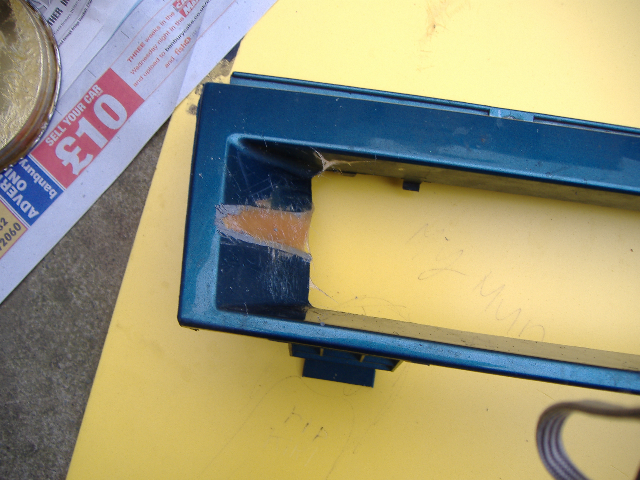

Hi all,
I took a disc cutter to my grill a few months back and never finished it off - you could say it looks pretty unrefined at the moment.
I was just looking to see if there was an off the shelf solution - like a debadged plastic straight swap replacement?
Or am i better off using a bit of fibre glass and filler on the one i've got?
Paul
never mind, i was watching dave on the telly quite bored (day off today), so grabbed nearest tool i could find - swiss army knife - and i finished off chopping out the grill - i then found some old isopon fibreglass out of the shed and ive fibreglassed a couple of the "holes" - pics to follow, my god it stinks in this house now.

yeah cheers, although i did find myself searching, but then realised i was just wasting time of which i dont have much these days, so just got to it. attached is some progress pics.
Yeah im aware the fiat badge is missing out of the grill which is bloody annoying (dont know where im going to get me one of those!)
The car had some slight front damage before i bought it - so the grill is already a bit broken (means im not so worried about chopping it up).

interesting, but i do prefer to use fibreglass as its a far more flexible solution - i find filler cracks after a year or so and i cant be arsed doing jobs more than once. so plan is to let the fibreglass set so its rock hard.
then apply some fine filler and sand it down etc..
you didnt see the whole of the job i did, that was just the end of the last thread (took me long enough to find that!) i used a 2 pack flexible glue to bond it, with the spare bits of plastic i removed (the slats )behind the holes as to strenthen the grill, because when you remove the slats all the strenth has been lost, then then sanded it smooth then a fine skim of filler, then prime and paint, fibreglass doesnt adhere as well as people think, and isn't very flexible which will crack and sink due to the heat of the rad etc, ive seen loads of uno fans go down this route which is why i did a thread The right way, only been in the job 20 years!! Ant!
