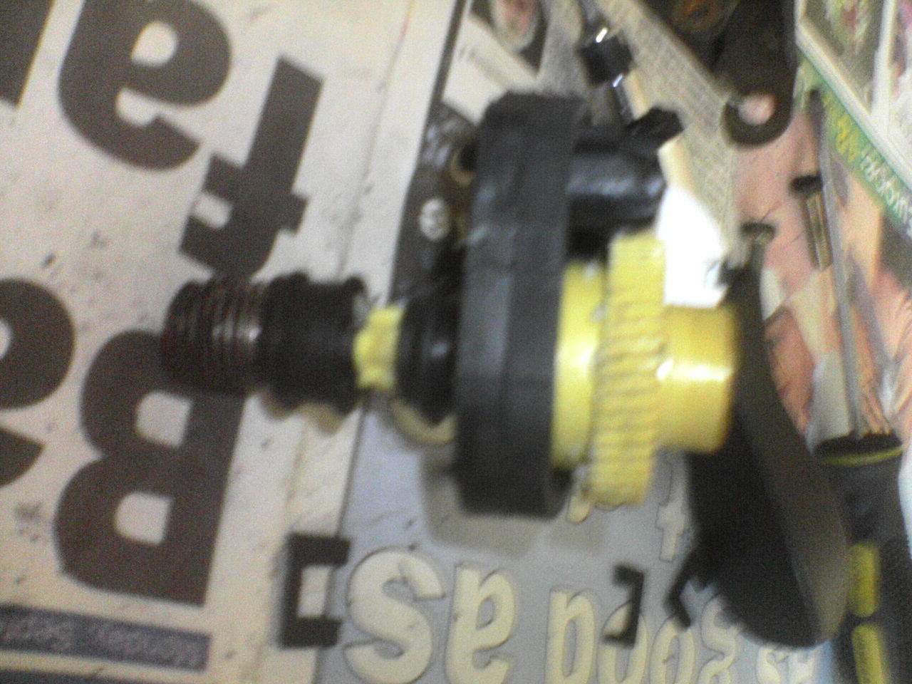

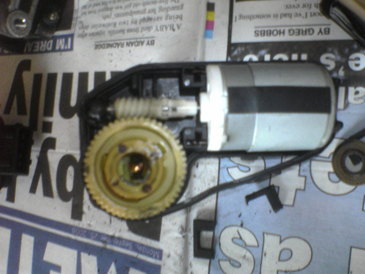

Still not working properly, but i think i've foundish the culprit. It is to do with the little button, whether its the automatic choke or not i don't know, but its fully electronic, so i doubt its dirt that causing it. What i thinks happening is that the button is fully out when i try to start it, but as i do this, it goes in, which is stops the engine from getting enough fuel. If i push the button further in, then it automatically comes out, increasing the amount of fuel, making it run fine again.
I've attached some photos (sorry their blurred, used my phone!) to try help u understand what i'm going on about, first picture is the setup with the accelerator bushel etc. 2nd is the inside of this thing, and third is how its connected to the outside. Basically something controls the motor which makes the thing with the springy bit on go in and out. That iny outy bit has a potentiometer or something in it i think which goes towards contolling the amount of fuel let through the injector.
Well, now i know the problem, but no idea how to fix it.
Any thoughts are very welcome!
Cheers
Ali
