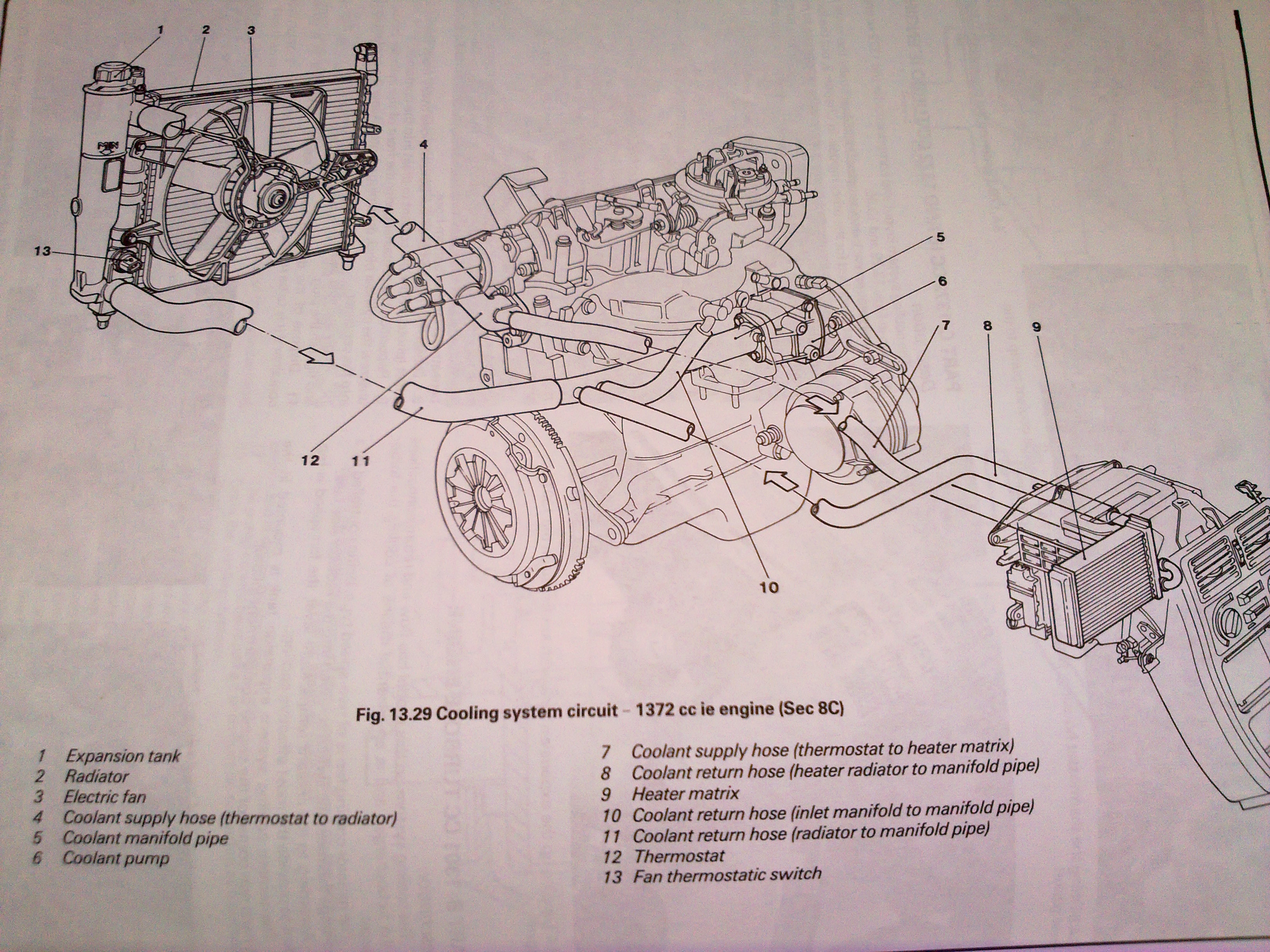

Hey Peanutville, which Uno have you got?
The coolant system is slightly different on the Turbos.
Attached are pictures of the Turbo coolant pipes and direction of flow.
Like hyperspace says though, the water pumps on all the Uno's are on that left hand side.
