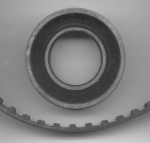

My tensioner went after cam belt replaced (my first post). When I got car I did not know history, so I had it done. When I went back to collect it the guy in the garage told me I was the luckiest man alive, it had done about 70K in 10 years on original belt (a bit overdue). He then snapped it with minimal force.
[Alex glad to see your mate did not have to replace their cam belt + tensioner. Mine was relay bad after being disturbed, but I can’t say I saw the unit “collapsed” or checked it for dirt. That would have kind of invalidated garages guarantee, and the car was new to me.]
It’s hard to explain the sound difference as their both belt squeals that track engine pitch/speed. In my experience, the cam squeal only started at higher revs, the drive squeal at lower revs but stopped at higher revs.
According to the garage that did mine, if cam belt snaps on 999 not much damage is done (to engine), but you could get stranded / need recovery.
The garage’s first method of testing if cam or drive belt was revving the balls of it and listening. They barely believed me when I insisted it was not the drive belt, and it wouldn’t do it for them for a while. When it did it got much worse. When they realised my cam belt was playing up they let me drive home.
Next day I took it back, they investigated, and had to order a new tensioner. Till the new part was fitted they were not so keen on (refused) me driving with a naf tensioner, but they sorted it and I got the old parts (attached).
If either belt is really loose or dirty I guess they could squeal till they fall/snap off, are tightened, replaced or cleaned. Drive belt is worth replacing regardless. Get a new one before investigating the cam belt. I guess the car will be at least 10 years old. Has its cam belt ever been done? If not be thinking about it, as you can’t see belt’s internal condition.
Alex’s cam or drive test is much better “…try removing the alternator drive belt and see if the noises continue”. Just remove it from equation, then if its not cam belt you will most probably sort it with new drive belt, worse case is its both. If you’re not sure of cam belt history, even if its not noisy, its also worth doing coz they can just snap.
If you do remove the cam belt’s plastic cover, be careful of rusty bolts. Use new ones if you can, as I sheared one completely when refitting. Luckily that was least important one.
