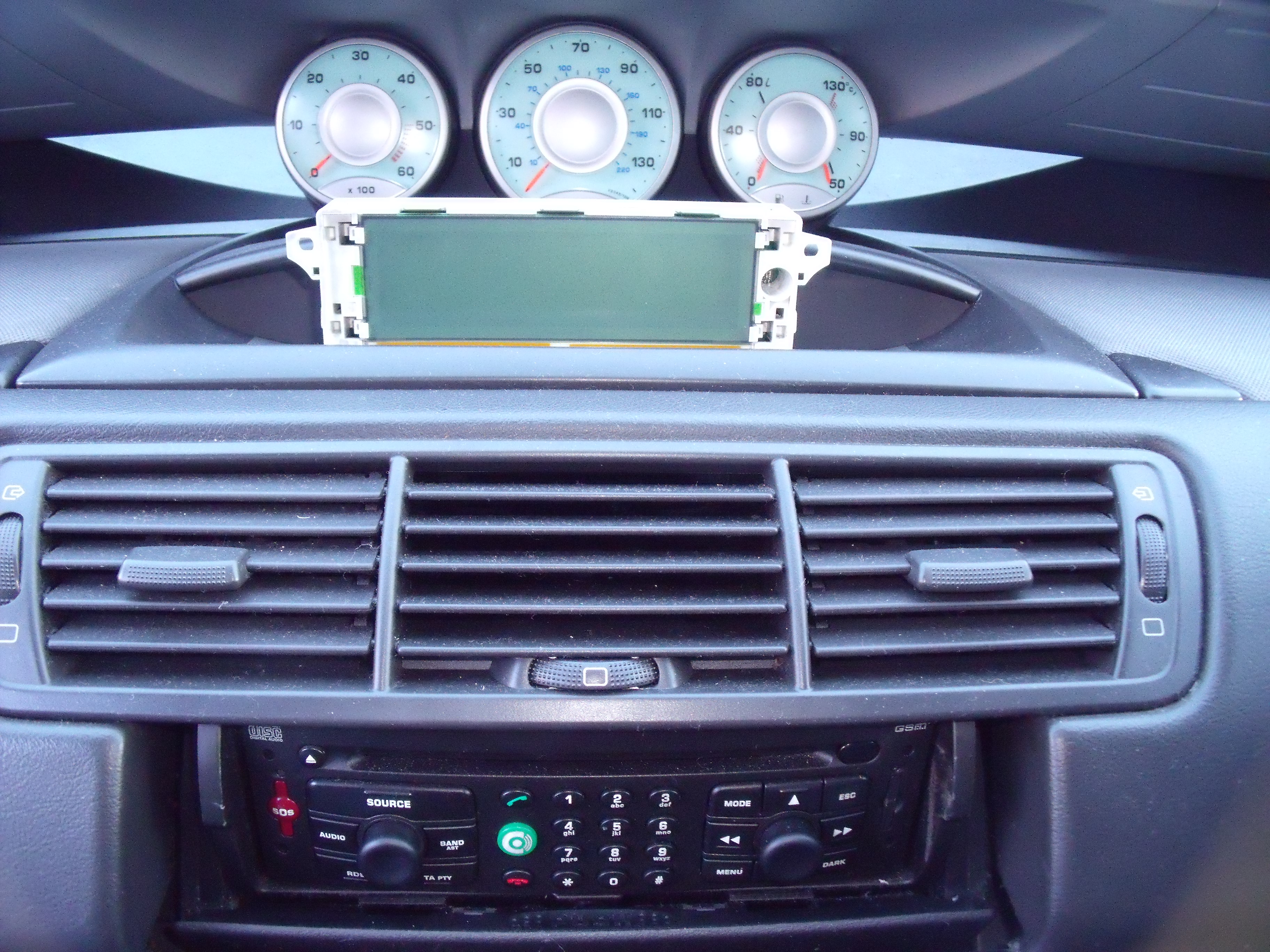

Sorry for the delay digger58, I have attached a photo of my music/LCD setup. Car beeps the whole time but I cannot tell why as I can't read this screen. My stereo keeps turning itself on and off too, then SOS light displays. I asssume it's because the car is trying to warn me about my engine issues.
That is an RT3 unit, you have sat nav and phone, I can see the slot on the right hand side for the SIM card. What does the screen display? if anything. I can't make out in the photo but does the unit have GSM on the top right, there are two types of unit, N1 and N3, if you take out the radio, or pull out the grille over the radio you may be able to see what is written on the unit itself. When we establish what exactly you have I may be able to help! BTW you will not be able to do anything until you get a screen working as you can not see what version of software the unit is running etc. Put the screen back in and connect it. turn on the unit and see if you get a Fiat symbol or anything at all .try pressing and holding the menu button for about 5 seconds for a soft reset. Its a start anyway(y)

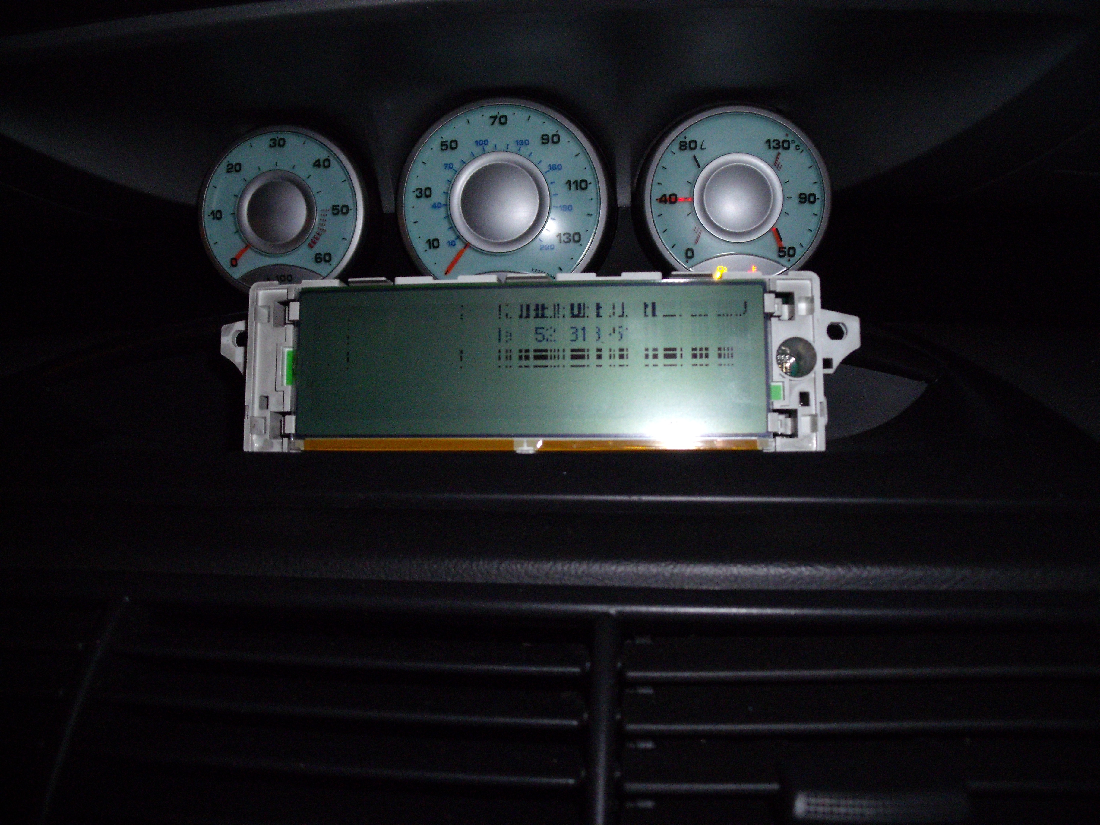

Yep, the stereo unit does say GSM on the top right. Screen is useless though - I've been trying to source one for over a month.
Right, the screen seems to be completely f..ked, that photo appears to be showing a bit of the GPS function, did you try the soft reset? Do you have the manual for the unit? Have you been on the eurovan2 site? lots of info there. Try a scrappie for a screen, they do come up now and again on ebay.:)
Thanks. That's what the screen looked like after a soft reset. It is never readable. Can't get hold of one of these screens - I'm always on Ebay. People only seem to be selling the slightly smaller one with 1 button either side. Is this an older one? If I ever get hold of one I'll get back to you thanks digger58. Loads of other faults with my car to look into anyway.
Thanks again digger58. I borrowed a screen off my brothers' neighbour and it told me no end of useless information (I could read it though). It said my navigation CD was incompatible, my child locks were on, I had an anti-pollution fault (like on my petrol 406 coupe) and so-on. However, the stereo did play without interuption. So, I've re-connected our broken/useless unit and the stereo seems to play music without being disturbed by the 45/60 second SOS issue.
