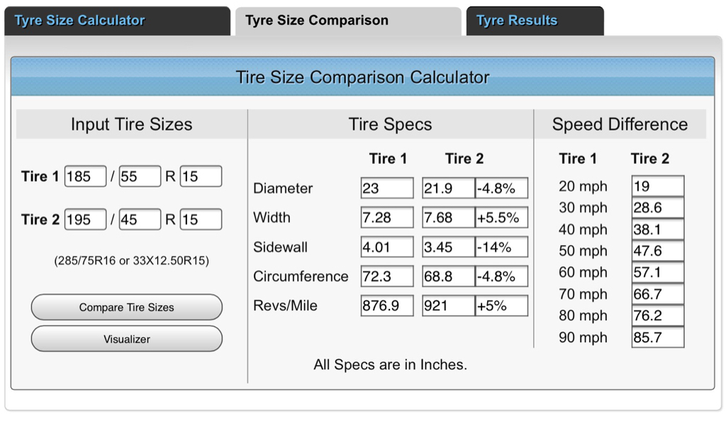

Another one i've just used says the following
the 195/45/15 tyre has (vs the stock 185/55/15)
-4.8% Diameter difference
5.5% width increase
-14% sidewall difference
-4.8% in circumferance
5% increase in Revolutions per mile
So in thoery the 195 should wear out quicker because its traveling furhter per mile
The website shows the speed difference, which aint hugely different @30
Have a look for yourself
Remember on 15" the stock size is 185/55/15
http://tire-size-conversion.com/tire-size-comparison/

As Ziggy said it will be fine at 10 - 20 - 30mph
But the faster you go the bigger the difference

Plenty of websites have comparison calculators.
You can see the difference at 70mph will have you doing an actual 66mph

Hi I have been looking at that website and really it should be ok as I don't drive very far to be honest the fatest road I go on is a 60mph so does that mean that my speedo shows a higher speed than I'm actually doing?

When your speedo says your doing 70mph - your doing 66mph
So your dash/speedo will probably say roughly your doing 74/75 todo 70mph
Tbh - i wouldn't bother touching it / trying to alter it
I'd like to keep it that way personally - your less likely for a speeding ticket
