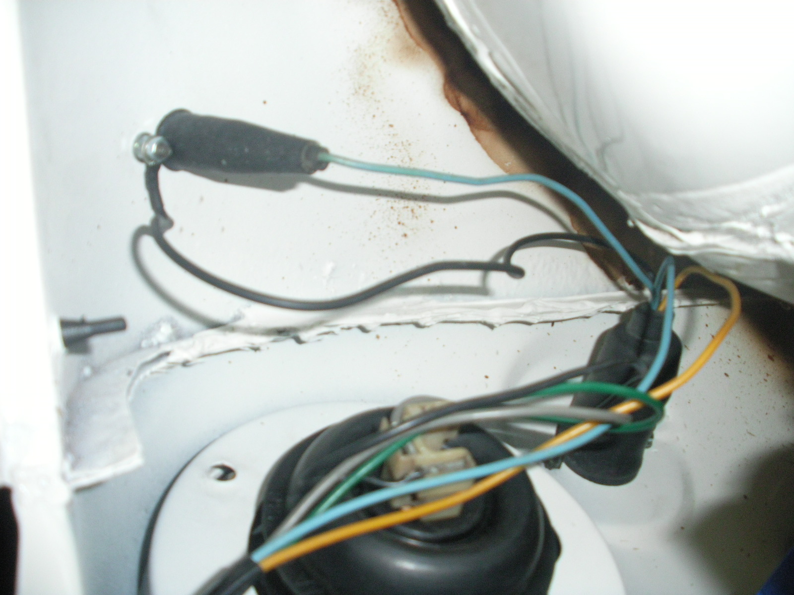

Please refer to my dodgy photo. You are only concerned with the side and front blinker and not the mess of wires for the headlight.

The front 'side' blinker gets earth because the light is bolted through the body. If the bolts (studs) are rusting then I think you will lose earth and the side blinker will not work.
The front blinker has an actual short black earth lead. This will be held somewhere against the body. In my case this short wire is held in place by one of the nuts that also holds the side repeater on. You can see this black wire and the nut that holds it in the photo. If this wire is not earthed properly the front indicator will not work. Throw your head under the bonnet and have a look and this will make sense. Again if the earth is an issue you need to clean the connection up and bolt it up again.
(Why the side blinker is earthed by the bolts holding it to the body and the front blinker has a dedicted wire I don't know.)
Now with my setup where both are earthed to the same point, if the earth at that point is bad, you would experience exactly what you are experiencing.
From your description I suspect you have a problem with the earth on the right front or a bulb failure.
Go carefully, the bolts holding the indicators are small, if they are rusty there is a risk of snapping them. Please let us know how you get on.
(You could make up a short lead with alligator clips on each end and earth the front idicators to a new source and see if that cures the problem. Less risk of breaking something and fairly quick and simple to do)
