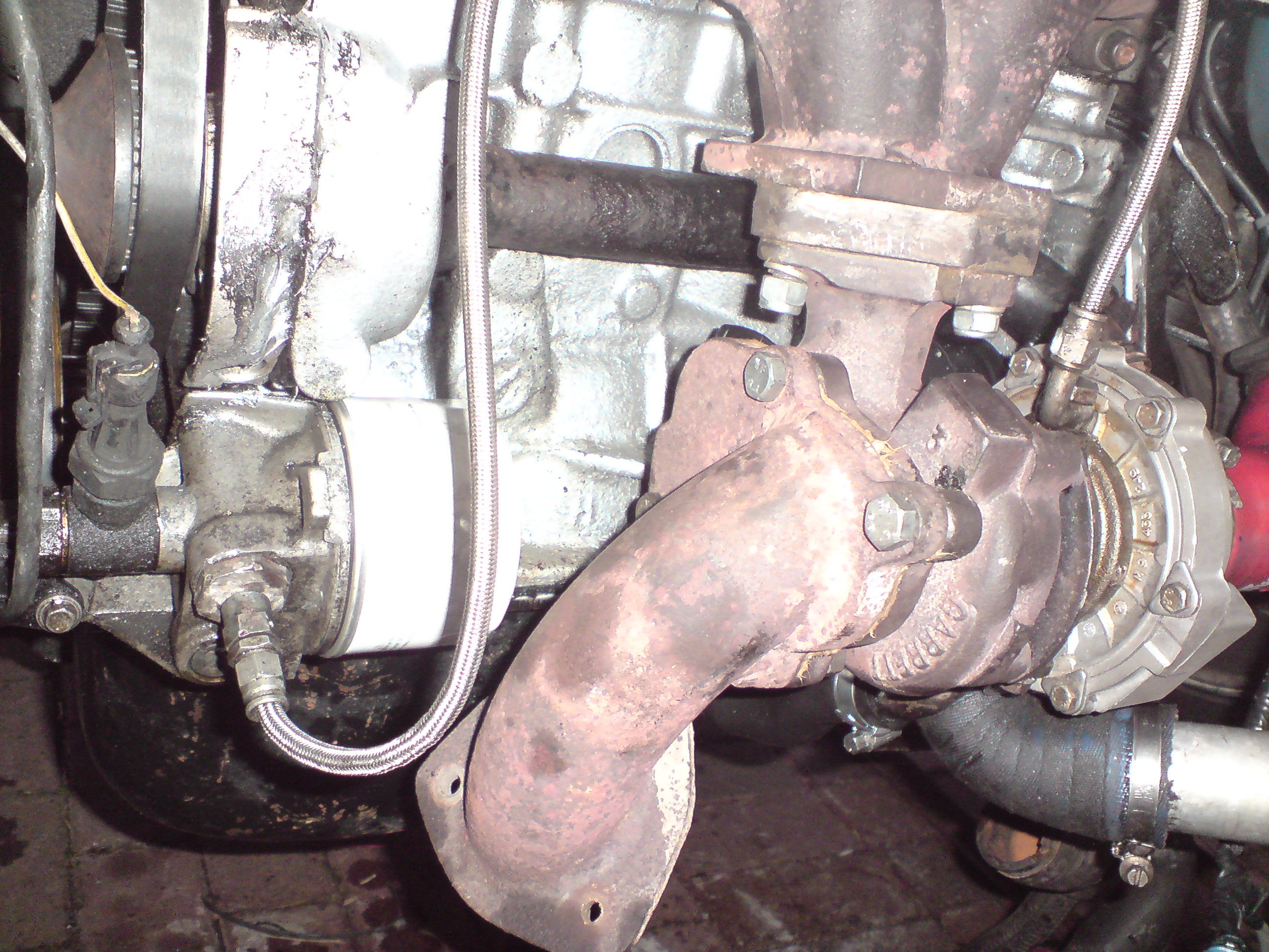

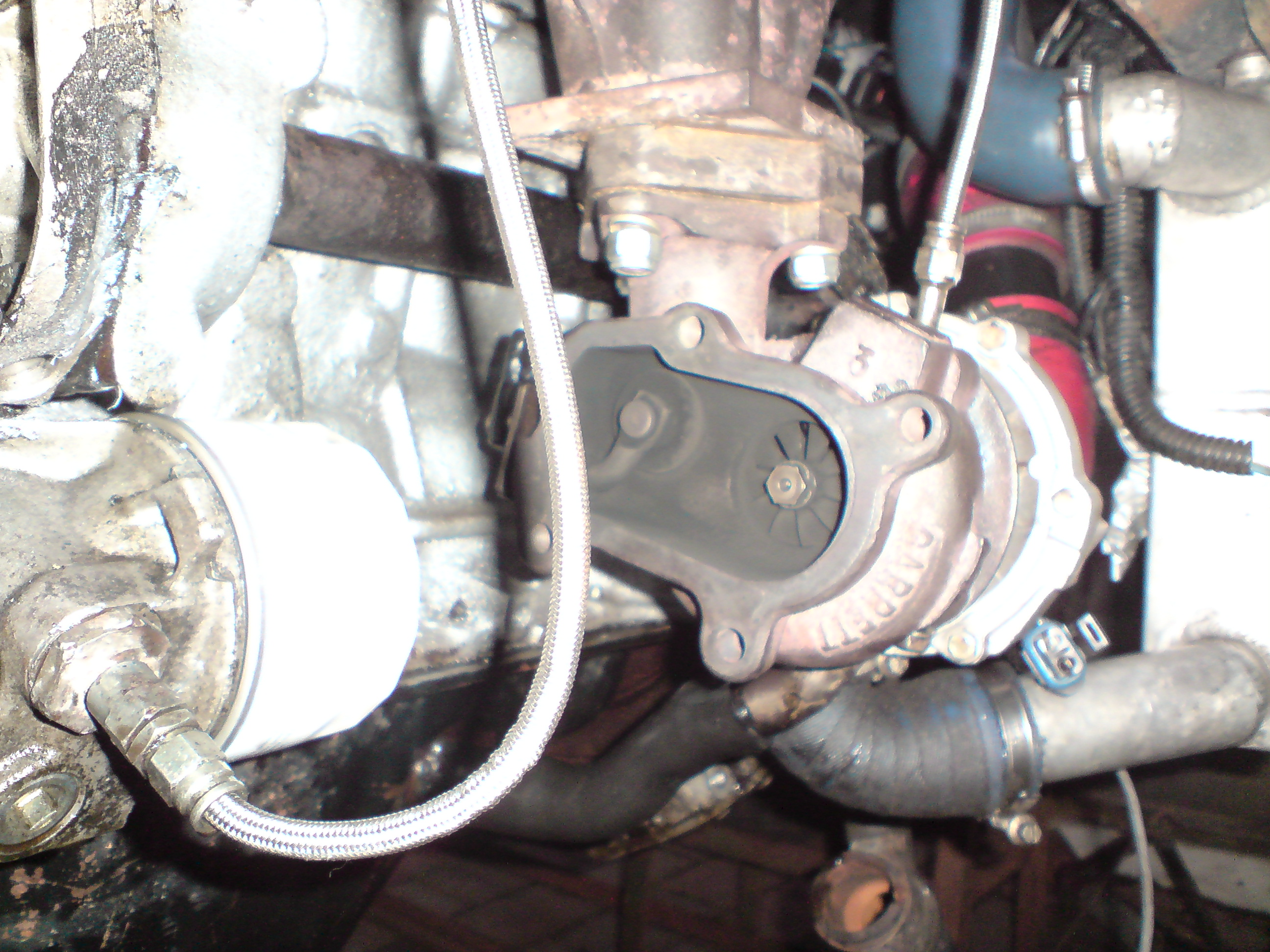

and any ideas what turbo this is and manifold?
thanks again lads
that will be the money sack of ****e i bought for parts.
just an astra turbo as mentioned.
the manifold is a cinq/punto55/60 manifold with a flange welded on.
there are hundreds of turbos that will work well on our engines and most of them will be much better then the astra turbo which is to small.
also the turbo is the cheapest bit. hope you looked into engine management and compression level
