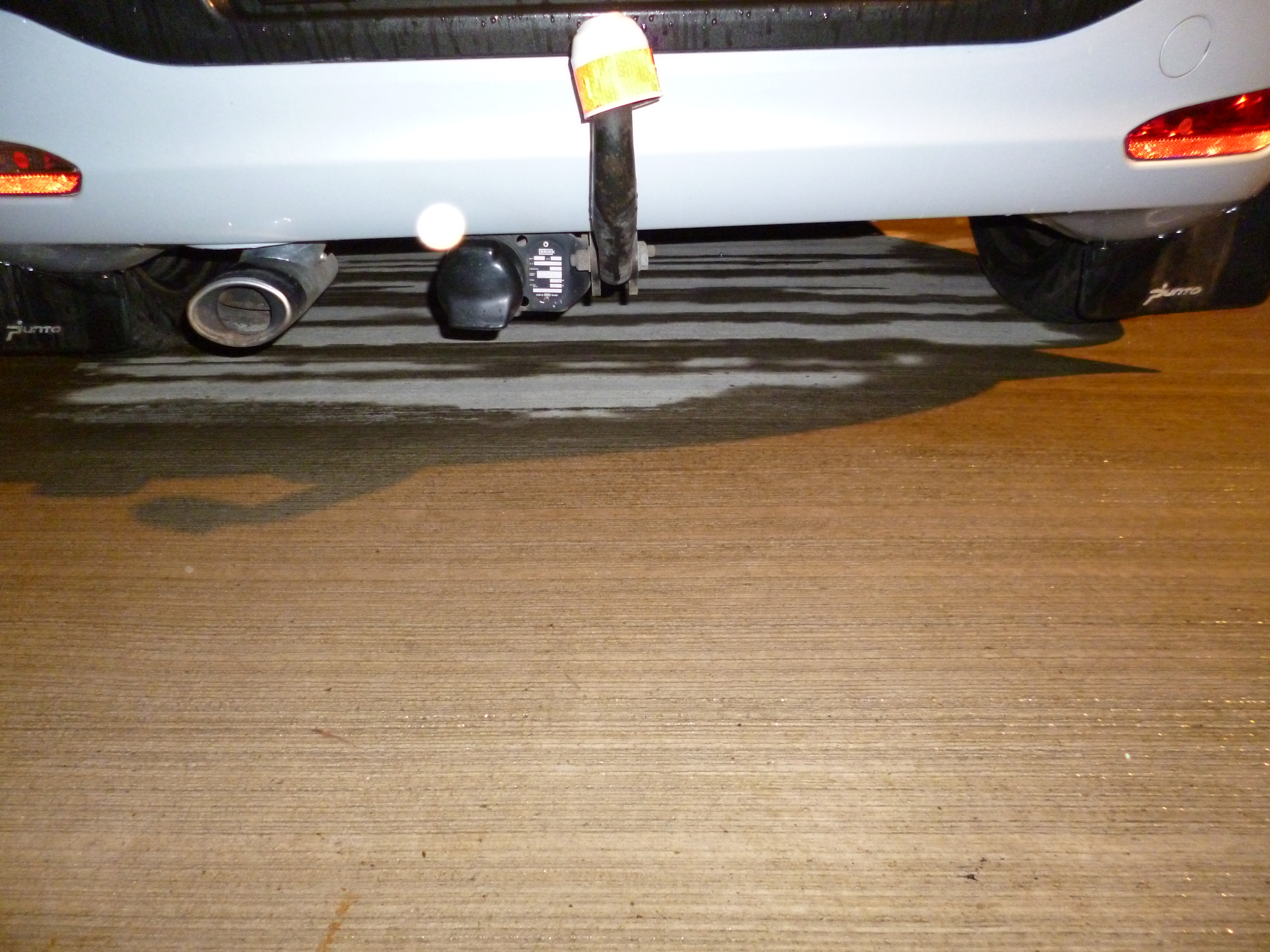

[mention=2879]andym[/mention]onty or anyone else who might know, i noticed you have a towbar so guessing you may have looked around are there any that dont require cutting the bumper to fit it?
the way the bumper curves under the car i think the only way to fit one will need a cut of some sort
hmm dont like the idea of cutting my bumper :eek:
but looking at yours even if i mess up it wont really be noticeable, let the dremmel see the bumper!
Much too brutal

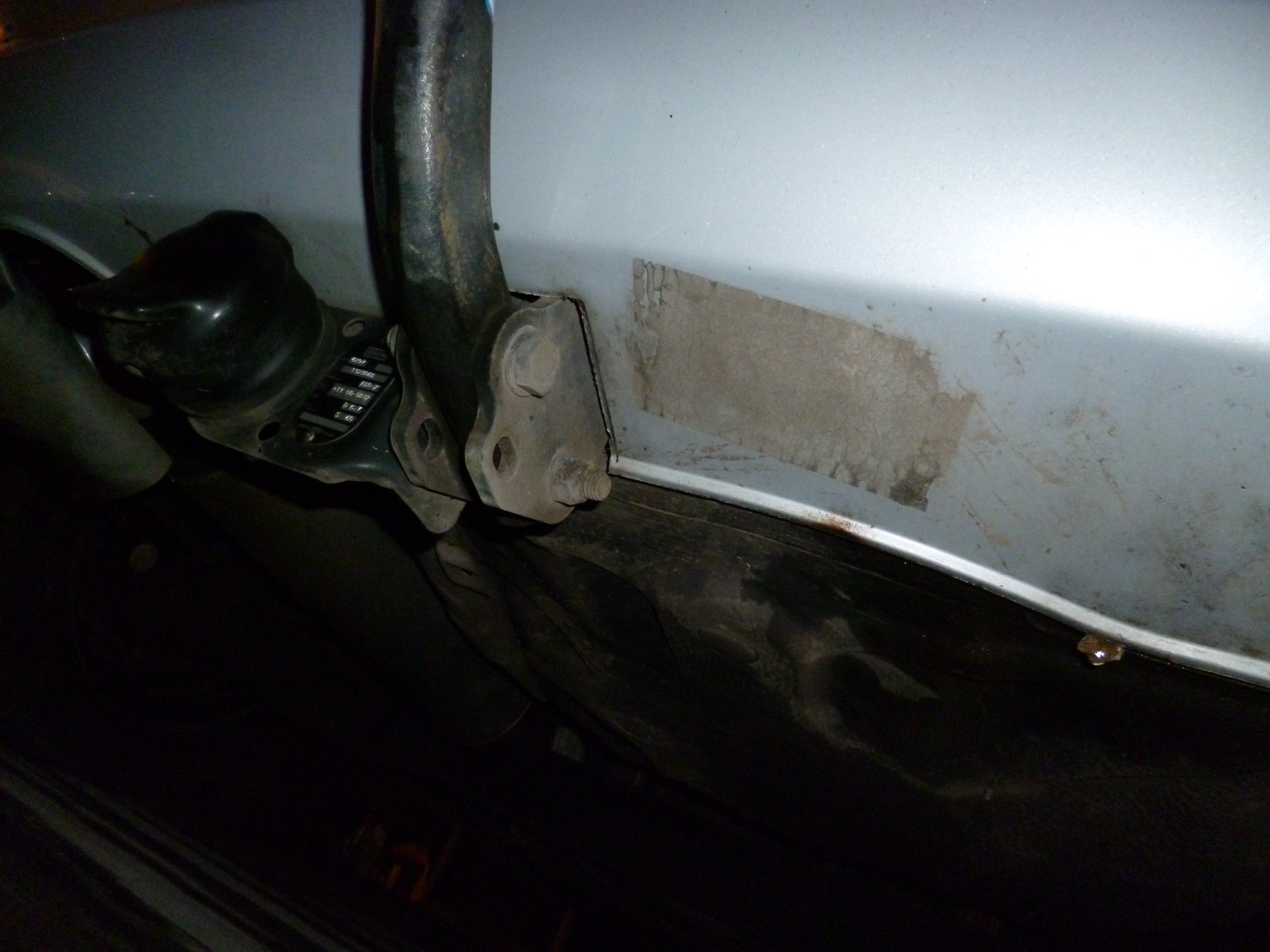

Cover area with masking tape Mark it.. drill 2x 10 mm holes in the corners
Then use a junior hacksaw to do the long downward cuts to the holes.. I then used a joiners coping saw with a fine blade to do the across cut
The masking tape helps support the paint minimising the risk of it chipping
