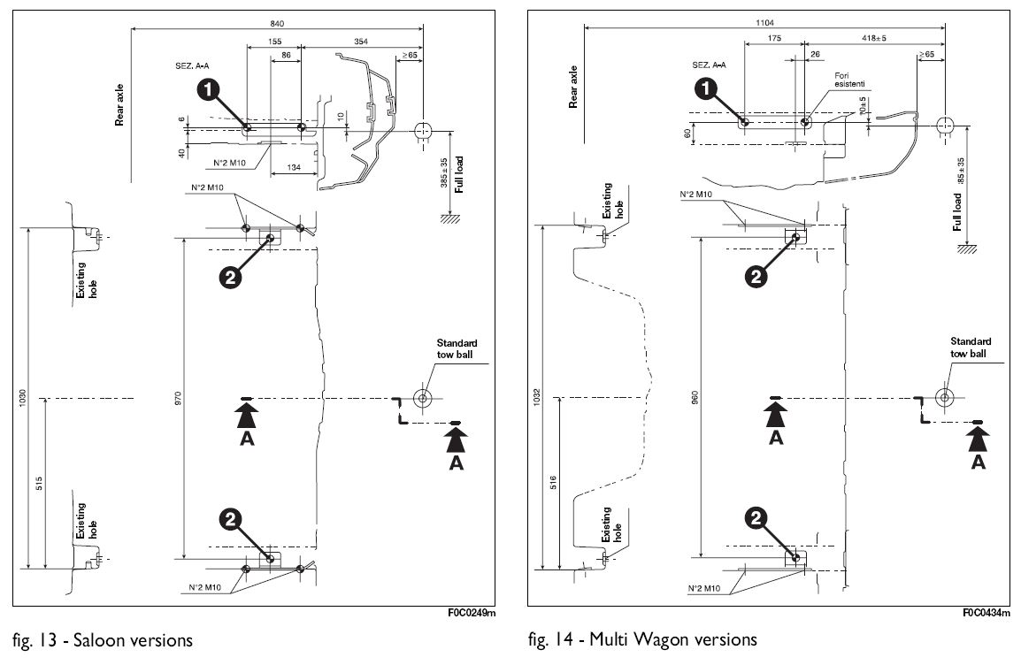

Do anyone know what is the mounting area / layout where to mount a tow bar?
Is there a plan or technical drawing available somewhere?
In the past I tried to get one fitted but nobody sold one for a Stilo so it must be made to fit, would like to fit a retractable one but space is a challenge.
