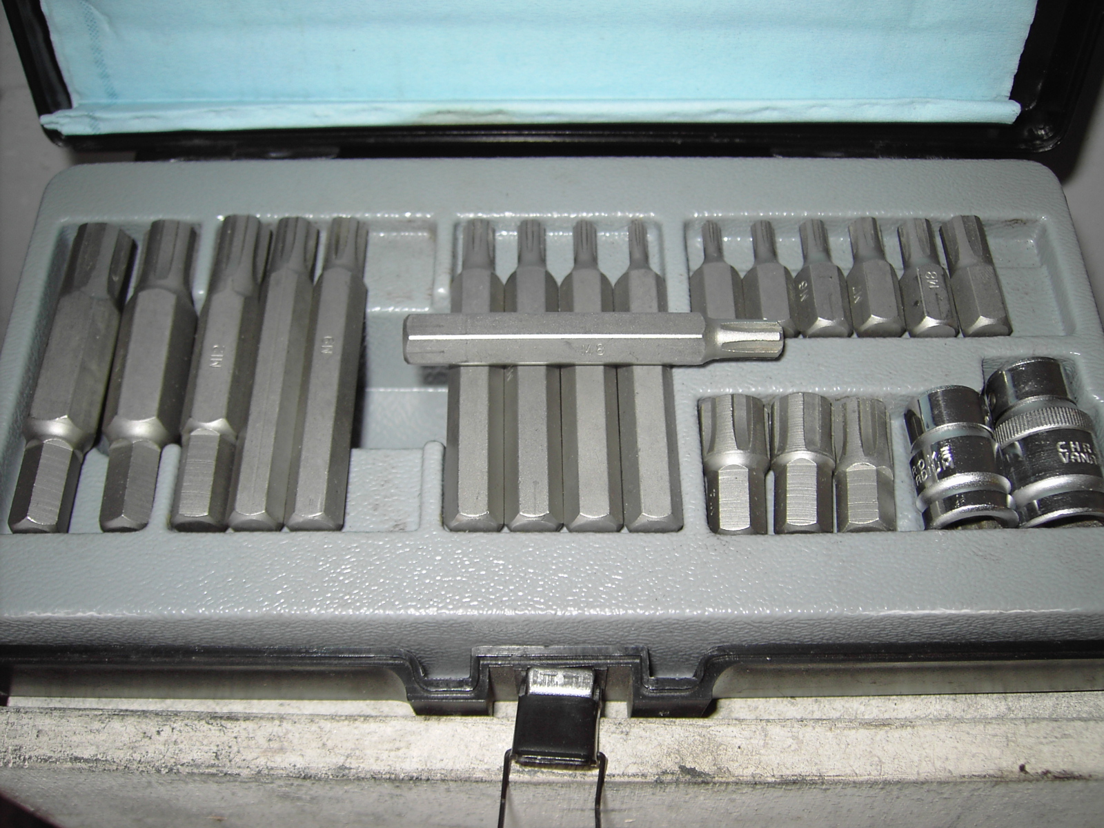

The splines on Torx and RIBE bits are a different profile. RIBE bits a have square splines as opposed to the more triangular profile of Torx bits.
I'm fairly sure the crankshaft pulley bolts are M8 RIBE. I seem to remember taking this picture when I replaced my pulley.
Thanks Davren - I'll just buy a RIBE bit set like yours.
