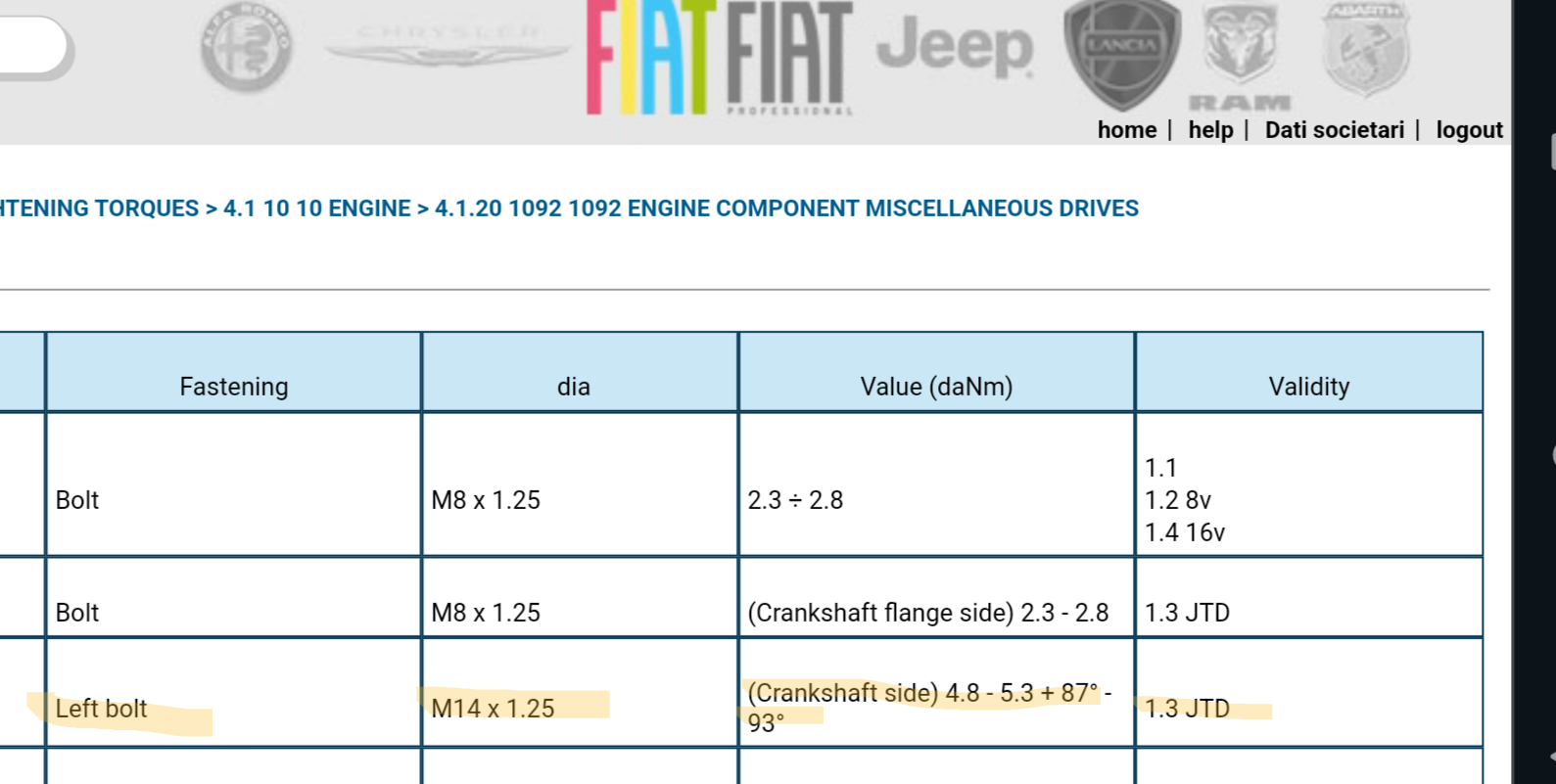

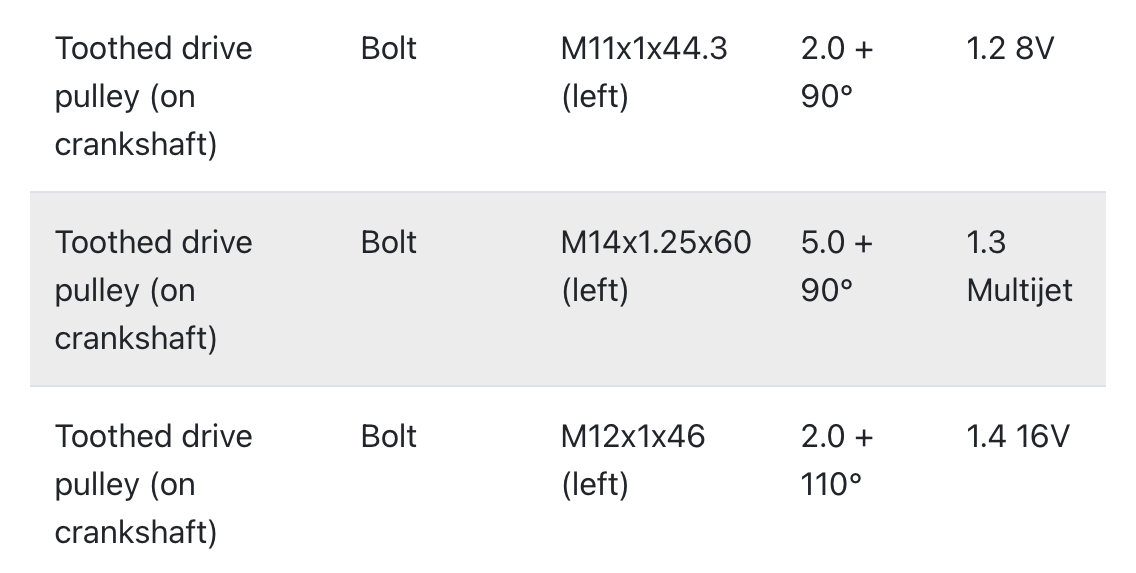

koalar Distinguished member Written a review Joined Oct 24, 2016 Messages 12,082 Points 3,532 Location Cheshire Jul 20, 2025 #21 Luisc said: Hi guys i have a problem on Lancia 1.3 multijet 95cv on the crankshaft pulley the tightning should be at 23 to 28 nm right ? Best regards Click to expand... The three bolts holding the pulley on right hand thread M8 Or The single larger centre lefthand thread M14

L Luisc Member Joined Aug 28, 2023 Messages 136 Points 82 Location Portalegre Jul 20, 2025 #22 koalar said: The three bolts holding the pulley on right hand thread M8 Or The single larger centre lefthand thread M14 Click to expand... Hi , the 4 bolts that holds the pulley m8 , the m14 is where? Is not on the pulley itself right? Attachments Screenshot_2025-07-20-17-47-49-544_com.android.chrome.jpg 891.9 KB · Views: 24

koalar Distinguished member Written a review Joined Oct 24, 2016 Messages 12,082 Points 3,532 Location Cheshire Jul 20, 2025 #23 Luisc said: Hi , the 4 bolts that holds the pulley m8 , the m14 is where? Is not on the pulley itself right? Click to expand... 4x M8 are the pulley bolts Correct Just checking nothing got lost in translation Luisc said: crankshaft pulley the tightening should be at 23 to 28 nm right Click to expand... Correct At least it is on the panda, can't see the lancia being any different

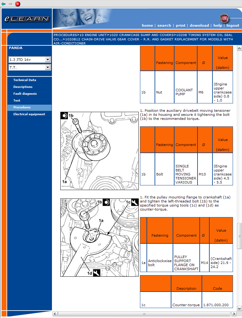

L Luisc Member Joined Aug 28, 2023 Messages 136 Points 82 Location Portalegre Jul 20, 2025 #24 koalar said: 4x M8 are the pulley bolts Correct Just checking nothing got lost in translation Correct At least it is on the panda, can't see the lancia being any different Click to expand... Nice yes i think they really are the same , and to remove the pulley , should i need to lock it some how? Any ideas? Thank you so much

koalar Distinguished member Written a review Joined Oct 24, 2016 Messages 12,082 Points 3,532 Location Cheshire Jul 20, 2025 #25 As per instructions 1. Fit a suitable (8 mm diameter) pin via the special opening in the gearbox to be used for counter-torque There no requirement to replace the bolts They don't come with any threadlocker Personally I would just torque to 25nm I normally put one drop of thread locker but it isn't necessary, just me being over cautious
