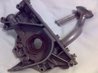

Lovely clean oil pump removed from the spare engine !
How does an oil pump wear out given that its just a wheel going round (in lots of oil too!) Is there a relief valve that can go - or is it gaskets? The pump on the car is covered in oily gunge.......which has built up again since cleaning when fitting the head. In reality, I presume the chances of the oil pick up getting clogged must also be pretty low??
This type of oil pump is a lot more reliable then previous types. Problems are usually with the return valve sticking. Wear can occur like a wheel bearing on pump wheel so check for excess play here. Pickup is usually fine if oil changed regular but what can damage the pump and engine is if the sump is dented upwards towards the pickup and all the silt/crud laying on the sump floor gets sucked up. Indeed, this is how the daft design of the 12v 1.4 engine got worn out so quickly. the design let the pickup to close to the sump floor. By shortening the pickup, this eradicated the problem.
