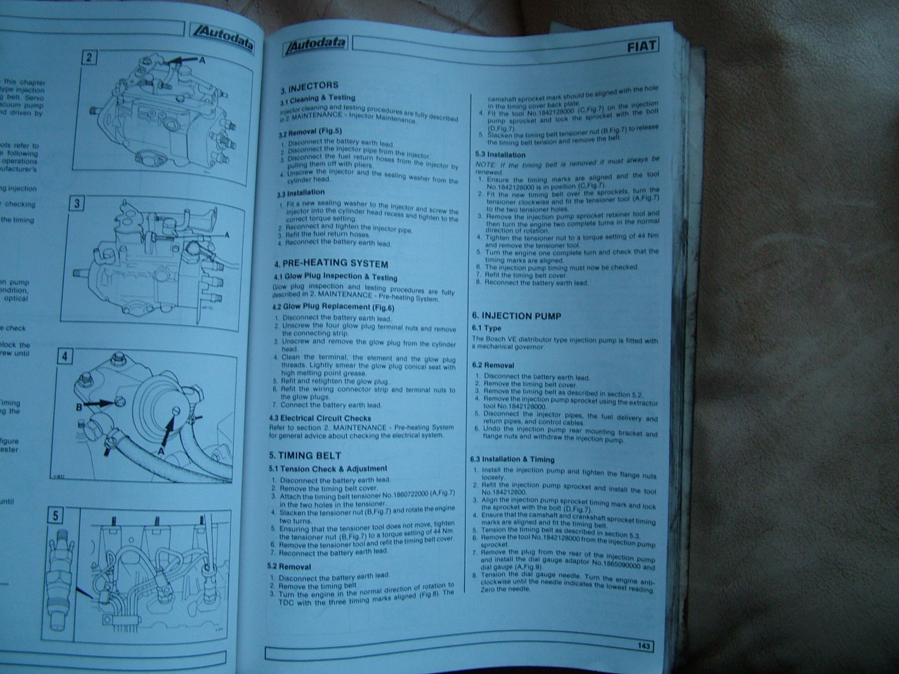

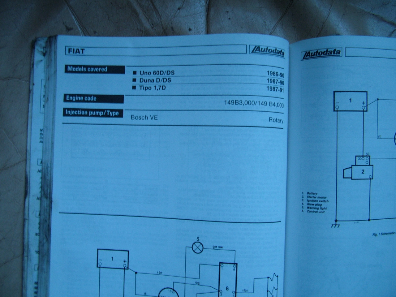

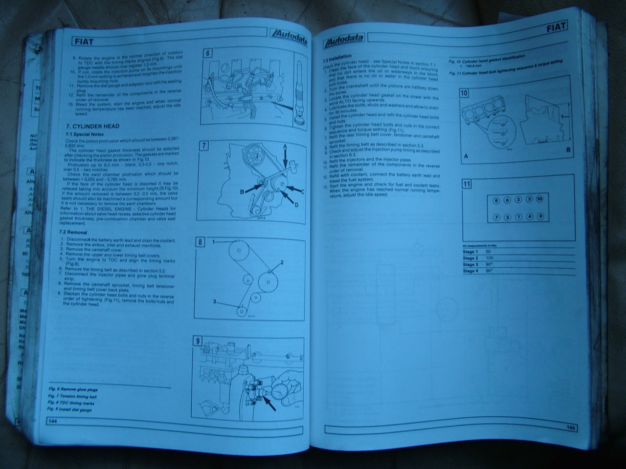

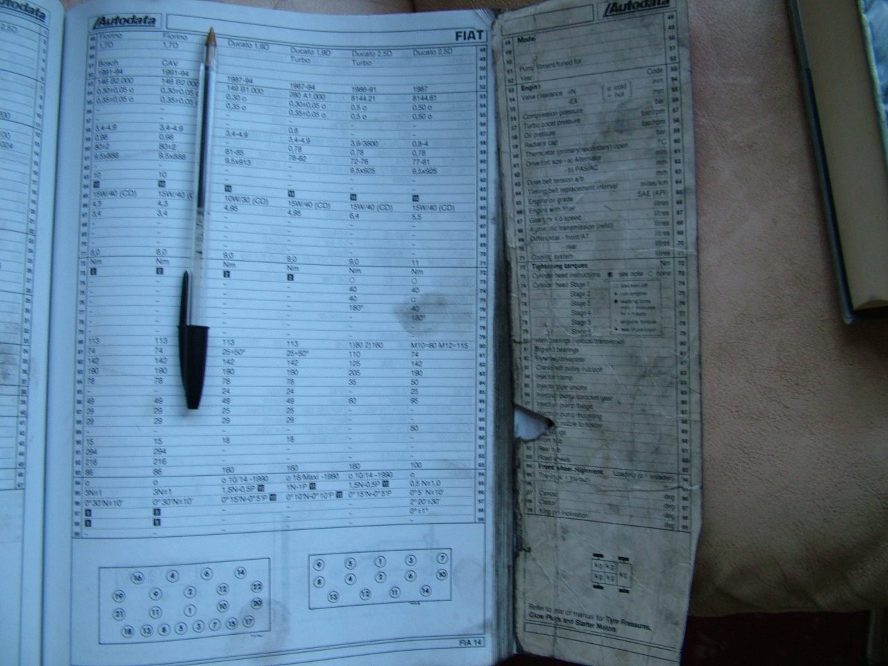

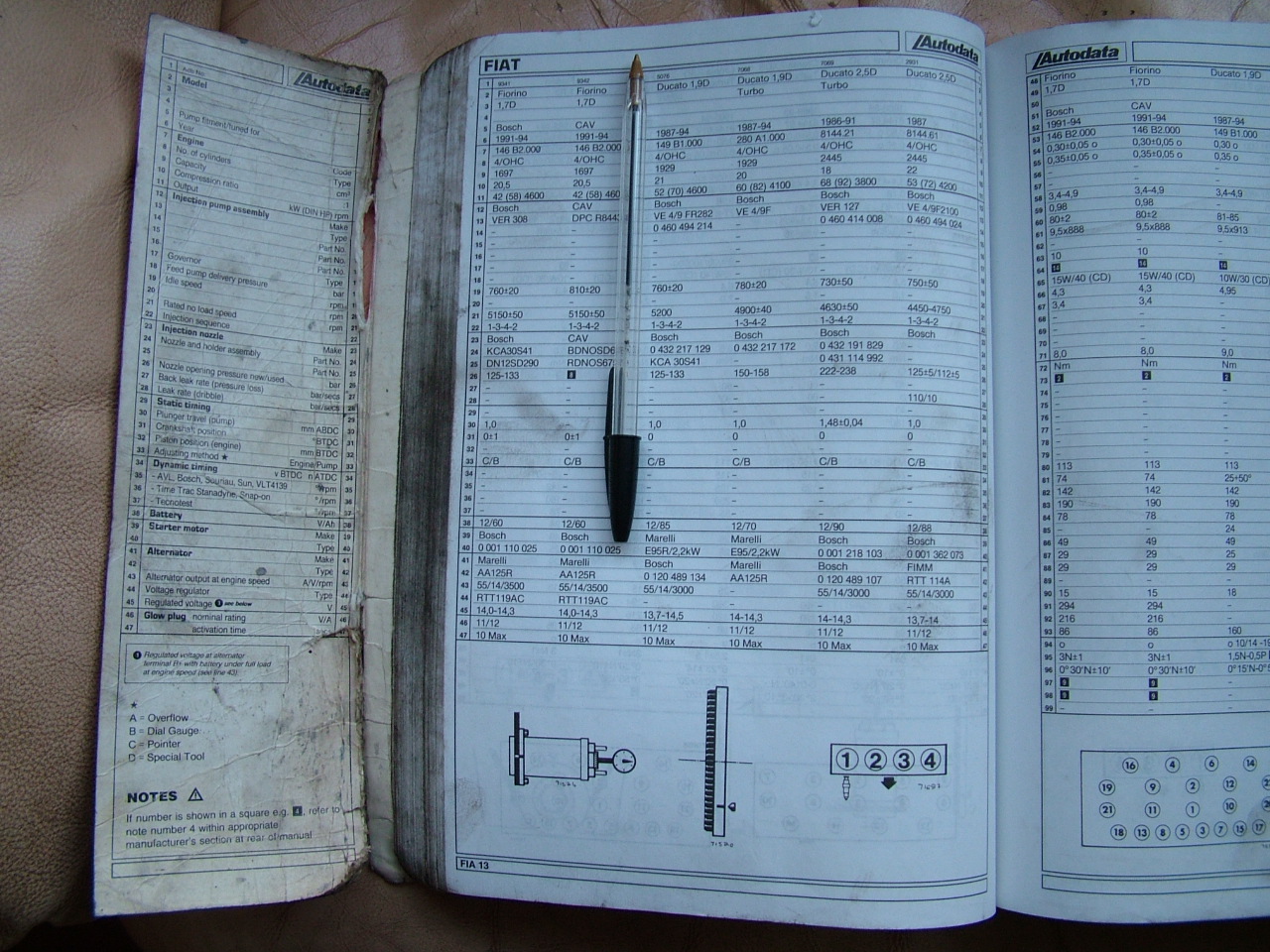

I appreciate this is the smaller 1.7 149B.3000 but if you check some of the details may correlate with information you have on your 1.9.
Again apologies for picture quality.

Thanks for this info. If it matches the engine when I get to do the job it might be useful.
Will see if anyone else manages to reply with anything else. Thanks again for taking the time to post.
