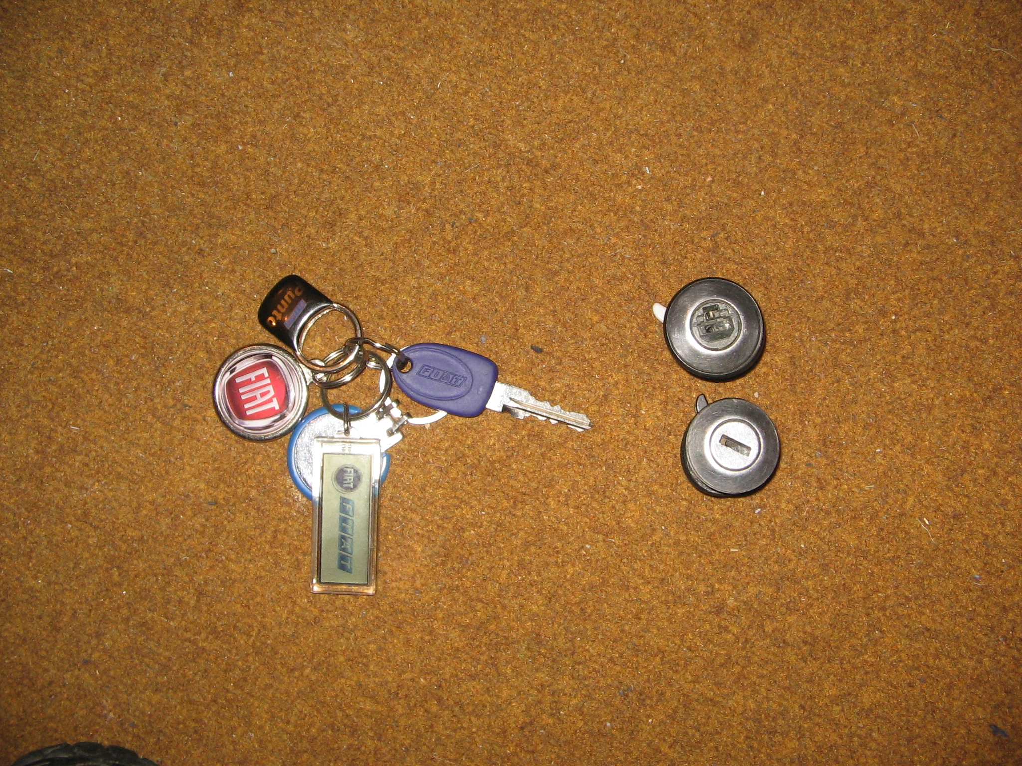

do what i done after someone done my locks remove all door locks/handles and get a proximity sensing alarm with door pops even if they put my window through they still cant get the door open as theses no mechanical way to open the doors its all electric ;)
So are them door pops what just pops the door open a little bit so you can get in? Any idea where to get them from?

i have smoothed door locks on my cinq,, problem is it worrys me that if the bat goes dead
all you need to do is fit a small plug somewhere hidden which will take 12v
like this:
http://www.maplin.co.uk/Module.aspx?ModuleNo=1397&criteria=connetor&doy=18m4
tape one under your rear bumper with duct tape or to the spare if its under slung and the other to live and earth dangling just under the front bumper that way if you cant get in because of a flat battery you can clip the other end to a set of jump leads and to a donor car and unlock your doors..
