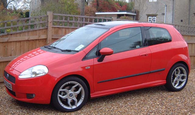

I know there have been other threads about "which alloys" etc. How about these that I had on my Stilo which I kept (traded it in with it's original 16's). I guess it's all a matter of taste but I think it looks more mean and sporty. It is, after all, the GP 130 Sporting. What do you guys think? (hope I've done this right !!).

Hi fellas, thanks for the positive responses so far. In reply to Shauncorwyn, they seemed to fit straight on ok but with a fraction more clearance around the hub centre where it sticks out for the bearing, probably just enough to stop it getting stuck on when you get a bit of corrosion. I was slightly worried by the fact that mine hasn't got all it's dust caps fitted over the bearing housings so I'll be taking that up with my friendly dealer, something you wouldn't be aware of unless you take your wheels off!

Good point, my GP tryes were originally 205/45/17 not 40's. Obviously the tyres on the claw alloys are right for the rims and the difference between 205 and 215 is pretty small, by my calculation it's about 1 inch in 77 on the rolling circumference (old money), ie around one and a half percent. I can't see that this is a problem unless any of you guys think differently??

their should only be water seals over the rear bearings as the fron bearing have their own seals they are cassete type bearings
Thanks for that littlepip17. I should have posted the answer to my own question because I consulted the dealer who, of course, told me the same thing. They'll be those wonderful "lubed for life" bearings ie when they dry out, they're dead !
well you shouldent worie about them drying up any time soon my dad has been working for fiat 25 years and the last time he replaced a front wheel bearing on a fiat it was a 128 and it had twin taper rolers on the front i beleive
wheel bearings is one of the fings fiat has realy got right but no one has realy noticed
by the way those wheels do loock cool on their but i'm not sure about fitment if the roling radius is diferent they will interupt the abs and speedo
if you want to keep those wheels i whould find a tyre sise that makes them the same roling radius
i believe michelin do a good sise and conversions chart on their web site
thanks again littlepip17, see earlier reply in this thread about tyre sizes. My dealer thinks there's no problem too. Shame Fiat didn't get everything as right as the wheel bearings :D
