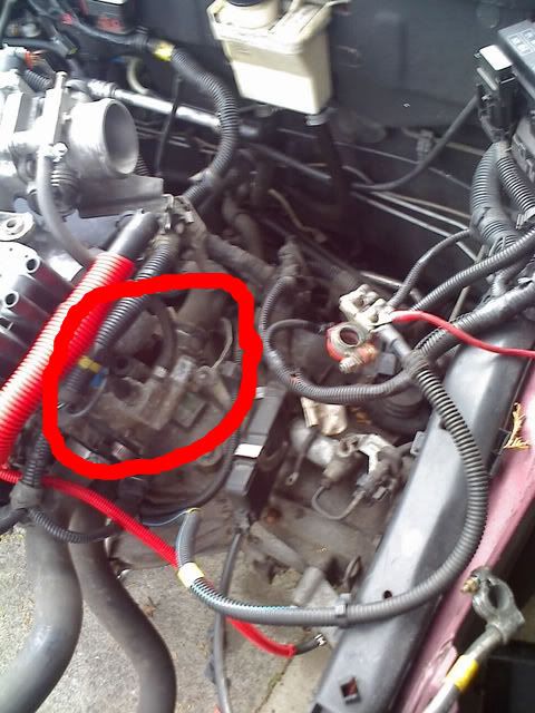

I have problem whith thermostat,can someone tell me where is position of thermostat in fiat Bravo 16V 1.6 1999. Is that easy to change ?
Thermostat is located on the number 24 where the temp sensor is. Simply fallow the big pipe from the radiator to it. Its simple to change, 3-4 screws and jubilee clips, but you must went the system afterward.
Members Site
Its on the right hand side of the engine block, with 4 or 5 black coolant pipes going into/out of it. As Sven said, dead easy to change, just make sure you have a handful of new jubilee clips. Also, you'll drain a couple of litres of coolant doing it, so you may as well just replace it all with new stuff anyway.
This is the sort of thing that you're looking for.
Picture courtesy of shop4parts which is also one of the cheapest places you can buy a new thermostat. (£43.68 for a 1.6 thermostat delivered)

there is it circled
but make sure when u order it, that u get the right one, there are 2 different ones, the mk1 has 2 sensors and the mk2 only has 1 sensor
