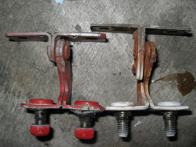

First I painted the replacement hinges, since they were off a red Uno 45 provided by jjhepburn along with another spare (pictured). A coat of aerosol primer, followed by a couple of coats of white two-pack paint sprayed thinly with an airbrush (also from jjhepburn), and a day or so to dry fully.

The reason is that turbo hinges are a different dimension (see pic). They also have a stop-pin built in. I decided that I could get around the dimensional difference by installing some thick washers between the hinge and the tailgate. The stop-pin isn't actually relevant - the strut tops out first.

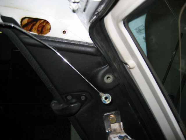

The strut ball-pin was also loose at the C-pillar. I tried to tighten it, but found the 13mm hex sunk into the trim. So, I started to remove it. It really was quite loose, so I continued to unscrew it, with a view to fitting a nice thick washer under the trim, and then... tinkle-CLUNK, the captive nut fell down inside the pillar.

Since the headlining was out, it was clearly just a question of lowering a 13mm nut into place from the hole near the top of the pillar. I thought about removing the trim to hopefully expose a more convenient hole, but then remembered that base-models don't have the trim (and there are no holes).
I tried using a telescopic magnetic screwdriver pick-up tool, but that needed bending for access, and then it snapped off.
So I took a heater hose and jammed some neodymium magnets in the end. Nice and strong, but again the hose needed bending and didn't hold its shape very well. What I needed was some wire to stiffen the hose, but didn't have any to hand...
...then I spotted the unused Uno door and spied the interior-handle rod - perfect - nice and malleable, with it inserted I shaped the hose appropriately and continued the fishing expedition. It only took about an hour of fiddling and the pin finally threaded in
The nut was of the type with integral washer/teeth, and I had coated it with Loctite to give it a fighting chance. Note the use of a ratcheting ring spanner, to give a certain kind of jerky tightening that helped the nut stay put. The pin did up nice and tight... over an hour later... the strut finally refitted.
