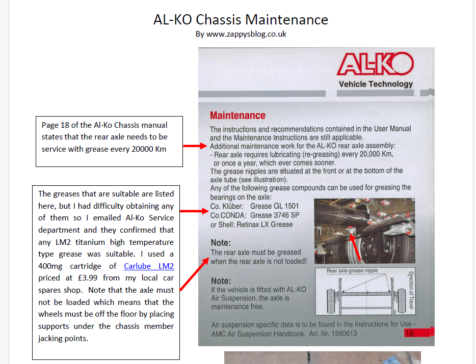

OP OP R Roadking01 New member Joined Jul 18, 2025 Messages 3 Points 1 Location Wakefield Yesterday at 10:56 PM #2 Has anyone had any issues with Fait professional dealer being unable to carry out 2024 Alko chassis service due to not being able to get the correct grease from manufacturer?
