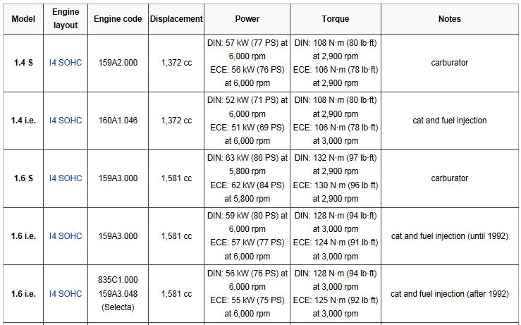

Hello guys,i have a big problem.I need to know the engine code from a Tempra,i have the VIN but in ePer it only shows me the engine number,not the code. The engine code is this : 8174885 ,and the VIN : ZFA15900007214654 . I need to know the exact engine code because they are different types of engines of the 1.6 Tempra.Please help,regards,Alex
From Wiki:
well in wikipedia it dosen't say full specs,but i finaly found out,the car is made in 1991 and i examined all the pictures to find out it's a carburator engine 1581 cm3 8v SOHC and the code must be 159A3000 but the question is now,it's the same engine like the 159A3046 (the same at the head and bottom end) one that it's a injection one?It's the compresion the same 8.5 at them both?
