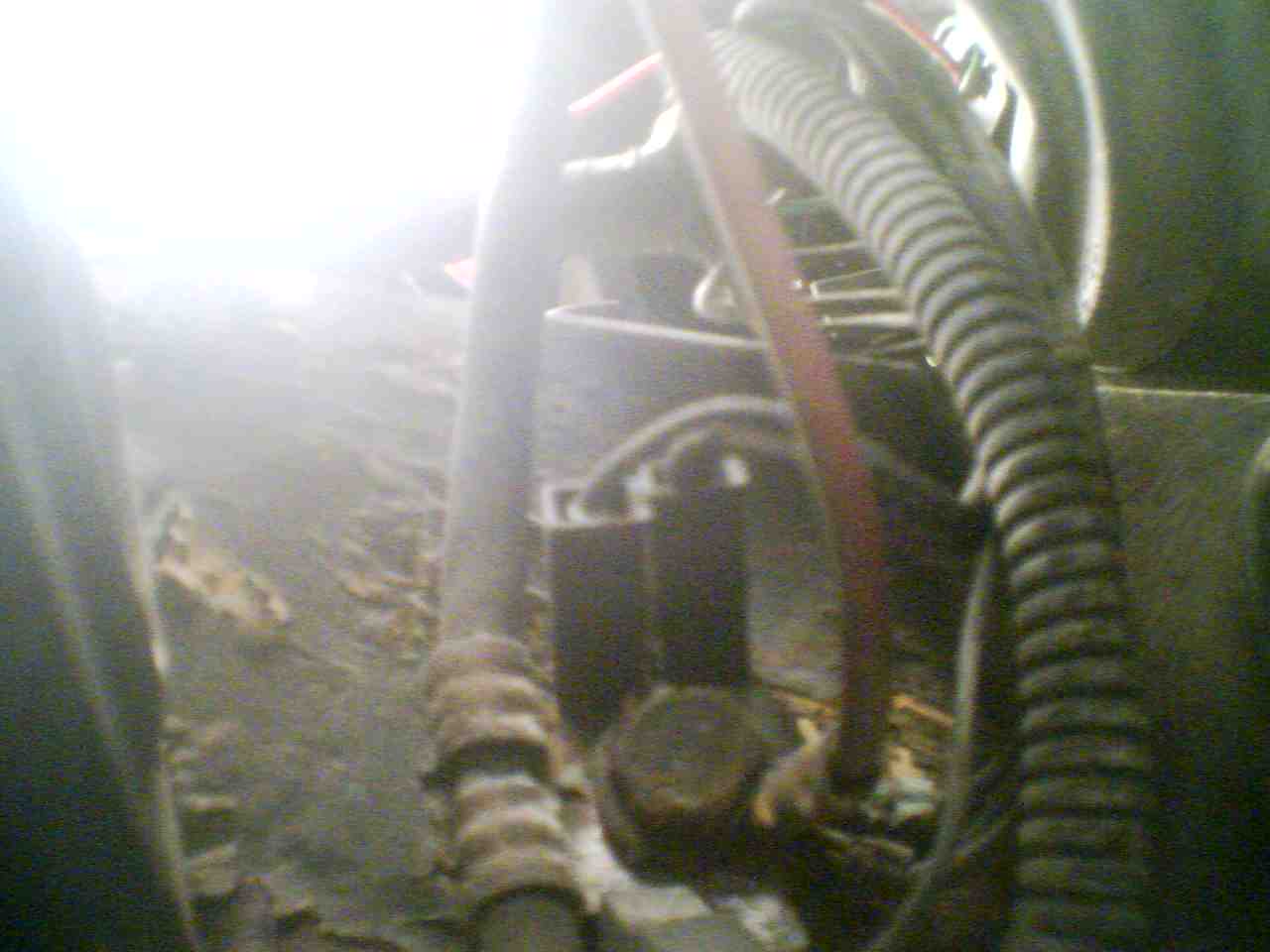

Voltage is between 7-10V when lights is on. Today I try to check and clean connections without results. Tomorrow I will check ground connections (pictures). There seems to be a lot of rustiness. New generator is recycled.

ok, no results after cleaning ground connections. Next step is to buy new accumulator....?
If your battery light is glowing, then it is probably something wrong with the alternator. Maybe a diode shortcircuet or a regulator malfunctioned. I think that is the couse of the problem. New acumulator won't solve anything. Just connect the old-one on a recharger. As for alternator, if charging works, the voltage (when car is running) should be 14.0 -14.6V. On my Tipo 1.4ie was once that kind of problem. Warning light was on and I drived for 2 days like that. Suddenly, headlamps went off and few seconds later, ignition system shuted down. Just remember, warning light does not apear for empty acumulator, it apears for false charging system. It is possible, that your "recycled" alternator is false, or it has a false regulator.
