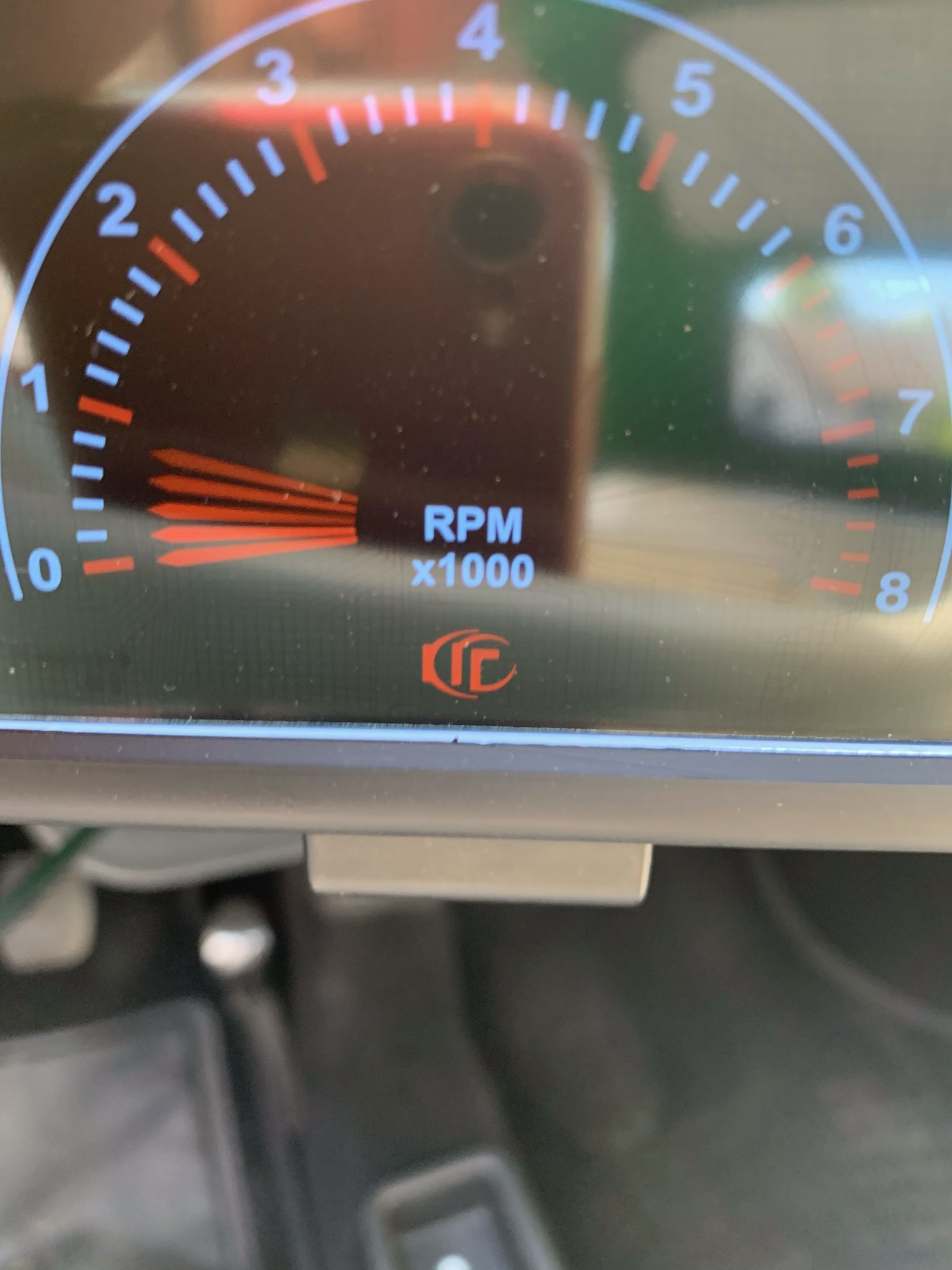

I have a digital tach that supports 4, 6 or 8 cylinder operation. I have an electronic tach convertor in line, so this doubles the signal to feed the 4 cylinder setting. To me, at tickover, of around 800RPM, it all sounds right. But I've posted pictures on the gram at 100kmh and the tach showing approx 3200rpm and I've had a few comments that that is on the low side. However the max torque of the 594cc is 3400 and max power about 4800. I also have a sync gearbox, so expect the final drive ratio plays a part as well.

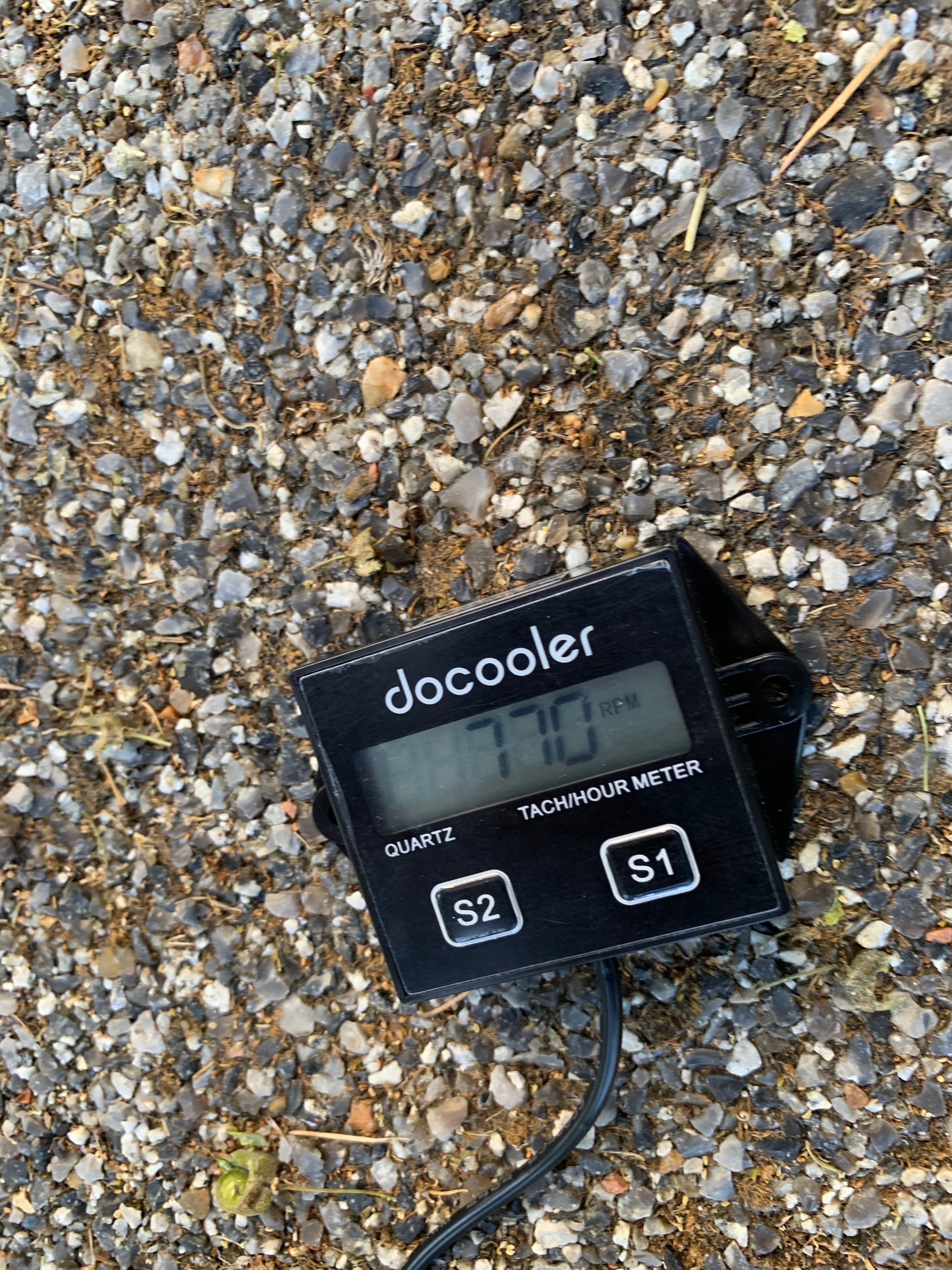

So I've purchased a cheap LCD 4 cylinder tach to connect to the neg of the coil and see what this says. If I'm getting circa 400rpm at tick over, then the original tach I have installed must be correct.If not . . . .

Me again. So as you may know I had some doubts raised over the accuracy of my RPM gauge when I had posted pictures up on Instagram. In essence, at around 100kmh, RPM shows around 3200. 594cc engine connected to a later sync gearbox. The factory specs for the 594 being max power at 4800rpm and max torque at 3400.
I have a digital Tach that is configured to 4 cylinder and use a signal converter to double the signal input.
After a run today, engine hot. oil showing 77c and idle steady. I connected up an inductive tachometer to a spark plug lead. The tach is configured for 2 pulse per revolution.
Results seem conclusive. (y) I’ll shut up about it now.
