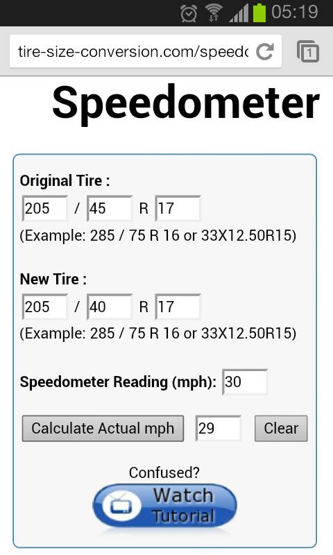

Sweex T-Jet! Parked in the garage Joined Jun 5, 2012 Messages 2,400 Points 546 Location Stroud Aug 29, 2013 #6 Here. 1mph difference at 30mph. Playerd around a bit and it is 2mph slower at 40/50. 3mph slower at 60/70/80. Considring all speedos over read, then it wont matter too much, plud youre going slower not faster. Last edited: Aug 29, 2013
