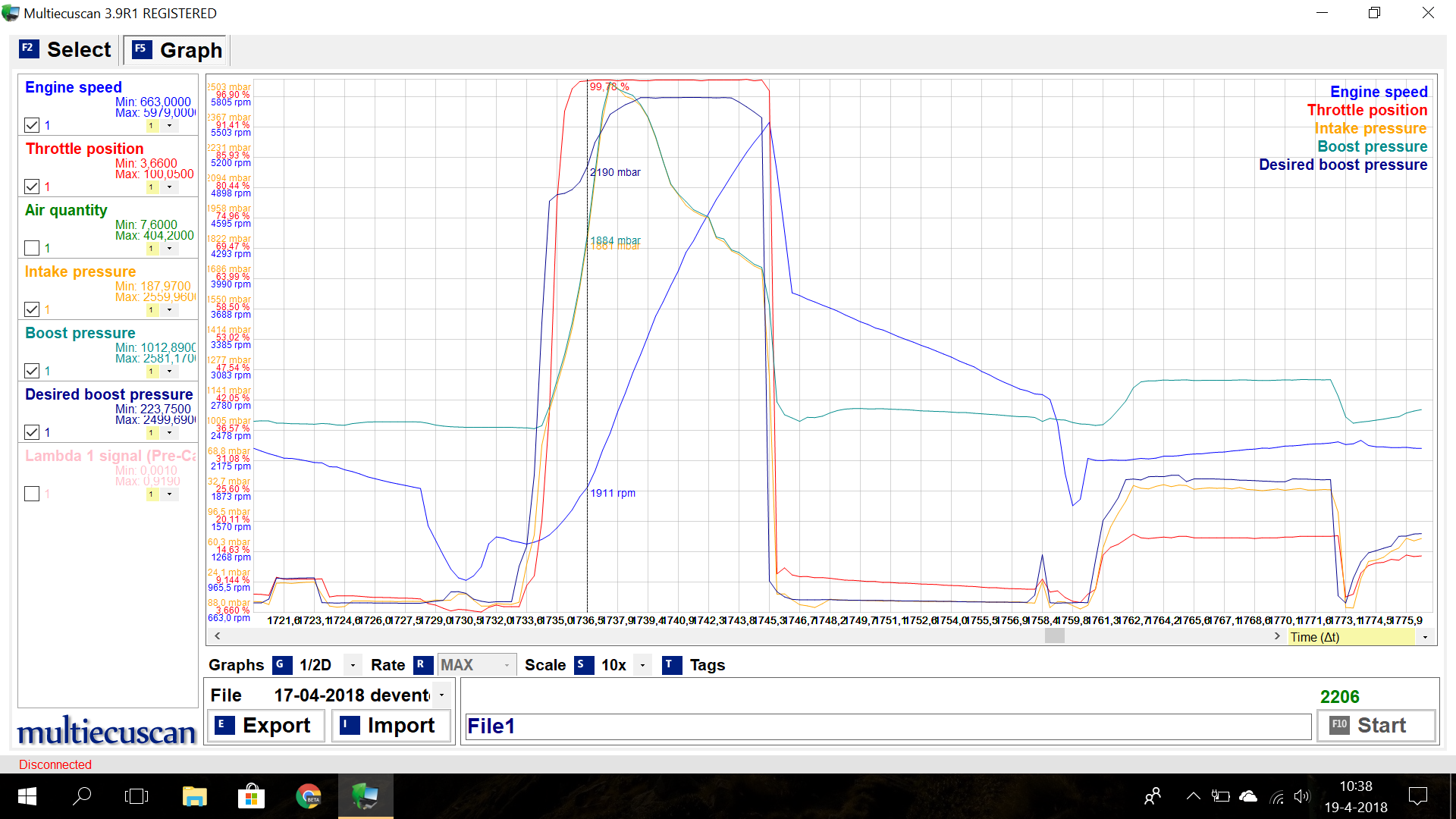

I am seeking some advice for a problem i have with my Grande punto T-jet (stock VL37 turbo).
My car has been chiptuned to around 140bhp, 250nm. Lately i feel like when i do a pull (put my foot down) that the car is holding back somehow. So as i have multiecuscan i connected the interface to the car and started a log to see what was going on (This log was made during a 30km trip with the a/c off, i added it to my post). Now when you take a look at the data you can see that the boost pressure hits the desired boost but after around 3200-3400rpm it drops off. My prime suspect after reading alot on the internet is the turbo actuator spring which could be too weak for the increased boost.
I am wondering whether i can check via multiecuscan if it’s the ecu opening the actuator after 3400rpm or if its the actuator spring that is letting me down. The only parameter I think shows this is the “turbo actuator command” parameter which is described in MES as “This is the duty cycle (in %) of the turbo actuator valve control.”. I did a 2nd gear pull with this (and a lot of other) parameter(s) selected. However I’m not sure how to interpret the data (I also added this file to my post).

The intake pressure keeps up with the desired pressure when i drive 'normally' what i mean with it dropping off is when i do a pull (see attached print screen) or do you mean that this is normal? my thoughts are that if the ecu wanted the boost to go down it would lower its desired boost value, but i could be wrong :).

The ECU keeps on asking for high boost since your foot is still on the floor, the delivered boost goes abruptly down because someone asked for: either the turbo reached its limit, but we'd more see a "plateau"or the wastegate has opened, which looks more like the curve we see. That should have been modified during the remapping but you already reach 1,6 bar of boost, which I believe is not that bad ...
And BTW, a "weak spring" would also show a plateau, not a drop.

there is obviously something going wrong there, is it the result of wastegate opening too soon or does the turbo efficiency collapse ? very hard to tell :-(
We can clearly see that the actuator command is starting decreasing but the boost pressure keep going down eventhough the desired boost is still at max... Is this a result of the boost pressure going down (so the ECU tells to close the WG) ?, again hard to tell...
The only way I see would be to by-pass the actuator so it would keep the WG closed; you'll have to pinch the hose that connect the regulator valve to the actuator itself, doing so the high pressure from the turbo outlet will not reach the actuator chamber and the WG won't open...
But be EXTREMELY carefull when you'll run the road test: since the boost pressure won't be limited anymore, you may destroy your engine/turbo. If you do the same kind of run as in the pic, you should be able to check the difference, no need to make a 20sec pull ...
