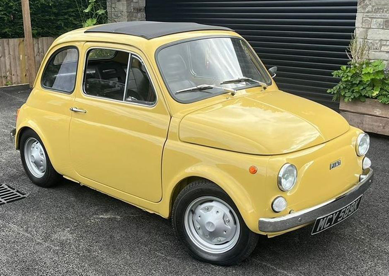

I will take some better pictures of the actual springs fitted but here is one showing how the car sits.

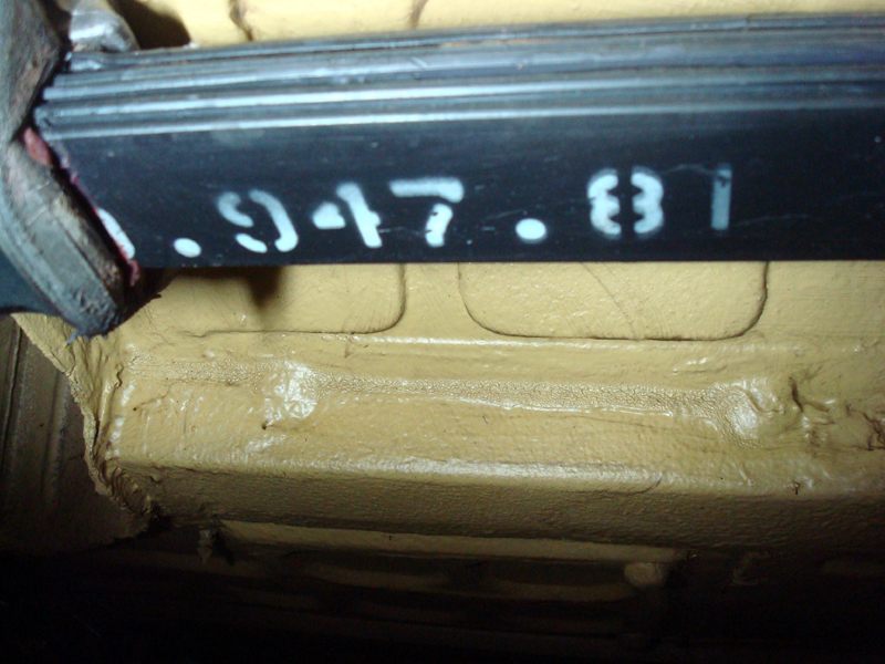

I have looked again at the 500R suspension and taken a few photos. The leaf spring has 5 leaves and the ends point upwards which explains the lowered body. It has a painted on number partially obscured by the bracket ??.947.81 . The dampers are red but I can’t see any numbers.

3. Do the numbers ??.947.81 have any significance?

If the ends of your front spring are turning UP, then you have a "reverse-leaf" spring". This is a 'lowering' spring and there is every chance that it IS stiffer.To keep the ride height level, I expect that shorter (and therefore almost definitely stiffer) rear springs have been fitted. To get a 'softer' ride, you will have to "go back to standard".

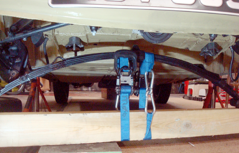

I have now fitted the 'standard' springs and dampers bought from Ricambio and the car rides much smoother over our rough roads. It was interesting to see that most parts suppliers offer rear springs of 220mm length for each mark of 500 but Ricambio have a 190mm spring as standard for the 500R and that's what I have fitted and it works fine. By chance I was able to compare the 220 spring with the 190 (500R standard) and the outgoing 190 stiff red spring, see photo attached. I still can't figure out why swapping the 190 red spring for another 190 spring, albeit softe,r would give a 1" high ride height, but I am not going to worry about it.
The front spring was, as suspected a bit of a faff to fit but I dare say I could do another one in half the time. I used a suggestion from Ray to load the spring with ratchet straps and this worked out OK after refining the technique.
