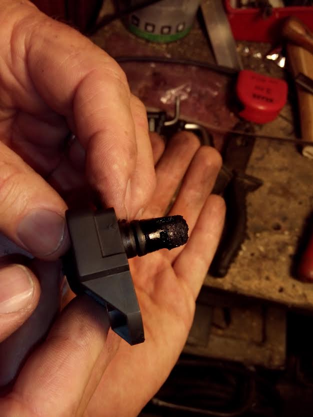

PS: The biggest problem with Fiat diesel engines is not EGR, but dirty MAP sensor.

if you have a picture of the back part of your engine with cover off, or at least from top wit top plastic cover off I can point it to you.I can do that perhaps on Wednesday...if you have the picture I can do it tomorrow morning.
I have cleaned an air flow sensor (the one after the air filter), also cleaned EGR, all two were very dirty. I dont know where the MAP sensor is.
