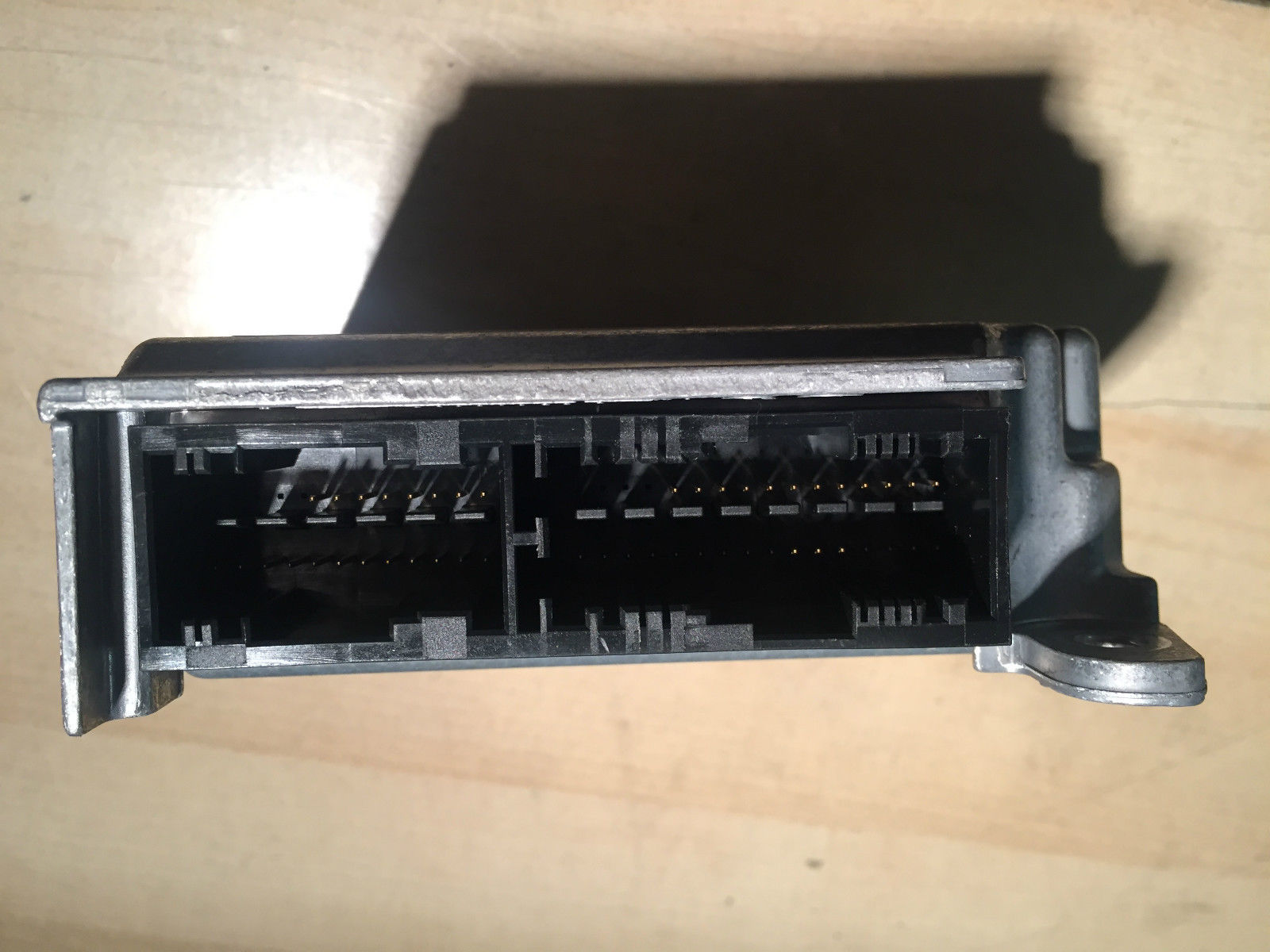

As far as I know, you can't disable airbags. The airbag ECU is different depending on whether the car has 2, 4, 6 or 8 airbags. Depending on which airbags you have left after removing the seat side ones, you may be able to get an appropriate replacement ECU, however, the ECUs and the connectors have different locating grooves and number of pins.
