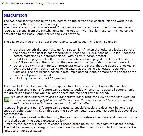

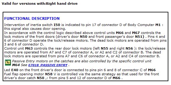

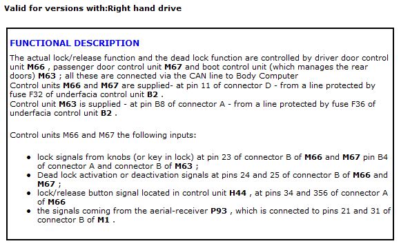

Below is the information and wiring diagram from the eLEARN workshop manual. It's for cars without Passive Entry. Not many UK registered Stilos were fitted with PE.
There's also a wiring colour code list, but often the colour code letters marked on the wiring diagrams are wrong.
If you still want to install the eLearn manual, let me know how far you got with it.

Hi There Davren
Thank You For The Circuit Diagram Through That Ive Now Found The Fault and Fixed The Issue :D It Was Fuse No 32 In The Dashboard fusebox that Was Causing The Problem All Along but i couldn't of found it without your help thanks again

I see there is a little confusion as you said in the handbook and in the wiring diagram with the fuse position of the central locking it says f36 in the handbook but in the wiring diagram it says f32 the wiring diagram was right and i went straight to the problem i did,nt look at all the fuses when i first checked as i could,nt get them out as there is no little fuse tool but as well as having a multimeter ive got myself a little test light that found the duff fuse after looking at the diagram
