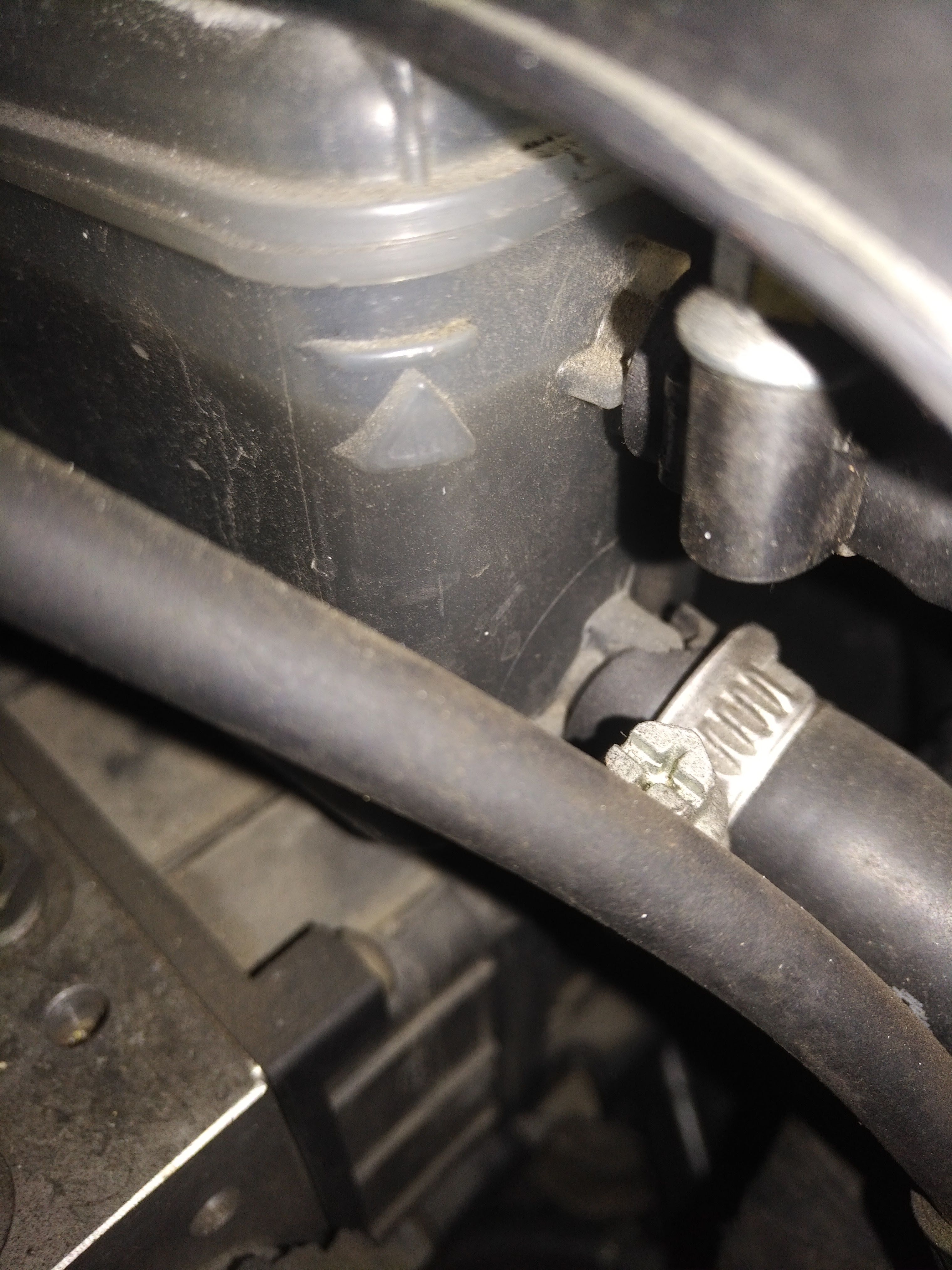

Hi All, the Selespeed in my Stilo has started playing up, it decided to drop into neutral at midnight and leave me stranded at the lights... :cry:
- It was mostly driving fine before the fault, it did drop into 1st while I was slowing down 15min earlier (not sure if I somehow caused that)
- No error when it failed (it did briefly flash a gearbox failure fault about 700m up the road when going over a bump)
- Was unable to select any gears, no noise from gearbox.
I got it back to my place and checked over it:
- Gear Stick is working, ECU can see what gear is requested
- Hydraulic pressure is fine, sitting between 40 and 50psi.
- Selespeed fluid is below the fill line by about 5mm (photo attached)
- Error P1741 - Engagement sensor - was stored on the selespeed ECU
- Clearing this error while the car was running made the gearbox make a clunk noise, it then managed to get 5th gear and stall the car..
- Seems to be able to get between R and 5th, but stalls the car when running :bang:
Does anyone have any ideas before I take it to my mechanic?

Selespeed oil level was correct after a short drive so that does not appear to be the problem.
