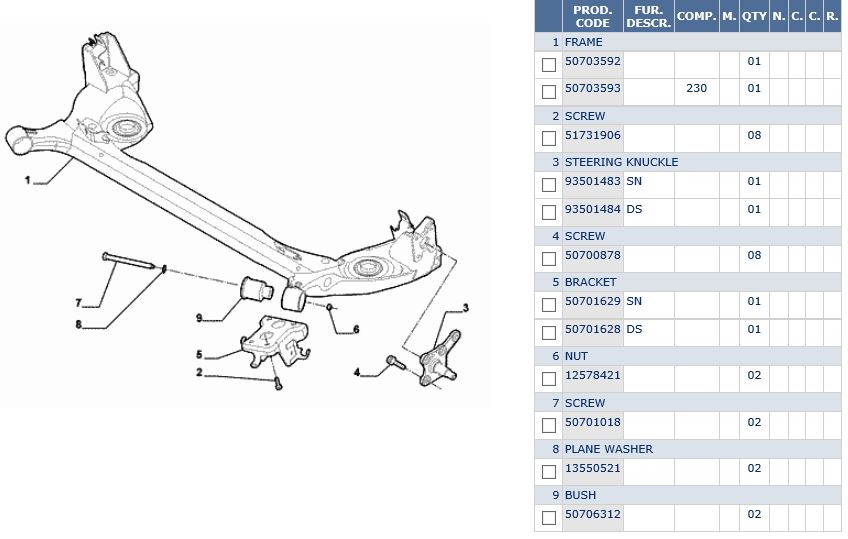

The ePER is alive again so I had a look.
There are just two subframes available for the whole Stilo family (post 2004 model year). ePER is dated 2007, so would be a definitive "source of truth" for a 2005 car. I dunno what Mangoletsi is looking at.. but since your breaker's sub-frame was different, there may be something to it.
Anyways, according to ePER..
Subframe: 50703592, is for any Stilo with regular headlights.
Subframe: 50703593 is for Stilos fitted with the gas discharge headlights (Option 230).
I have no idea why xenon lights would require a different sub-frame; all the other suspension parts are identical, but there you go.
Your part numbers might be different (e.g. begining in 7...) since Fiat re-organised their part numbering around 2008-10 but anyways, a dealer would be able to find a part using its old number.
I'm just wondering whether your car (or the breaker's car) has or had gas headlights respectively, for the subframes to be different.
Ralf S.
Here's the screenshot from ePER.
Ralf S.
The rear sub-frame for vehicles with original HID Xenon headlamps has a bracket welded on it for the rear automatic headlamp levelling sensor. So one with the bracket would also be suitable for vehicles without HID headlamps.
I recall investigating this for someone several years ago. Strangely, at that time, the sub-frame without the bracket was more expensive that the one with it.
Also, at some point, the handbrake cable, and brake pipe locating brackets welded to the sub-frame changed position.
