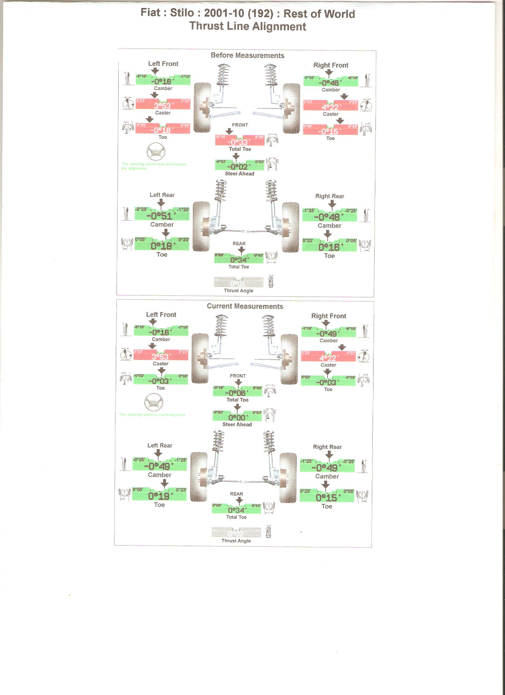

I had the wheel tracking tested locally, using a hunter 4 wheel alignment machine. The reason I had it checked was that a new drivers side ball joint was fitted for m.o.t, and that the drivers side inner edge of tyre was very worn.
The tracking tech said they had to make an adjustment because the front wheels were toeing outwards, attached is the report. my question is can anyone see from the report ? if there is anything I need to do or check, look at ?.Looks like the camber and caster are a bit wayward, I,m hoping the alignment will rectify the uneven driver side tyre wear ?
Thanks a lot
