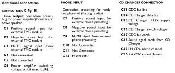

Now... i disconnect the Top connector - the can one that has the bluetooth module running through it, i left the iso connector attached and powered on the unit - still the same, stuck on PHONE.
I disconnected everything and left it for few mins, connected it back up with just the ISO connector and it was the same, i have connected everything back up and fitted the unit back in the car - the bluetooth works with my J5, Galaxy S4 and my sons iPhone 5s.
I had to clear all the stored handsets, holding both buttons on the roof - thanks davren, but i still cant use the Stereo part of my unit, i read that you can chop the phone mute signal wire and it will stop the stereo from getting a signal from the bluetooth unit.
However, when i look at the wiring diagrams above, the phone mute signal is on the can line connector, connector C (the top one) this has already been disconnected when troubleshooting so chopping the signal wire would do nothing, it appears to be an issue with the stereo itself or possibly the bluetooth unit has done something but i doubt it as it works....
The CAN lines are usually on pins 1 and 3 of the power supply connector A, (as in the diagram above). If it's different on yours, then the wiring must have been changed by Fiat at some point. We need the later wiring diagrams to check. Still can't find my 2006 version, so if you have a 2010 version of eLEARN, I'd definitely like a copy.

I have checked all wiring and it appears that its the same as your images, its not changed, however - the standard ISO connector on pin A 2 - it is the mute option that invokes the PHONE on the screen and switches source, to test if this was shorted - i snipped the wire and insulated either end, connected up the stereo and its still the same, i also left the stereo disconnected for around 20-30mins to soft reset it but it did nothing.
