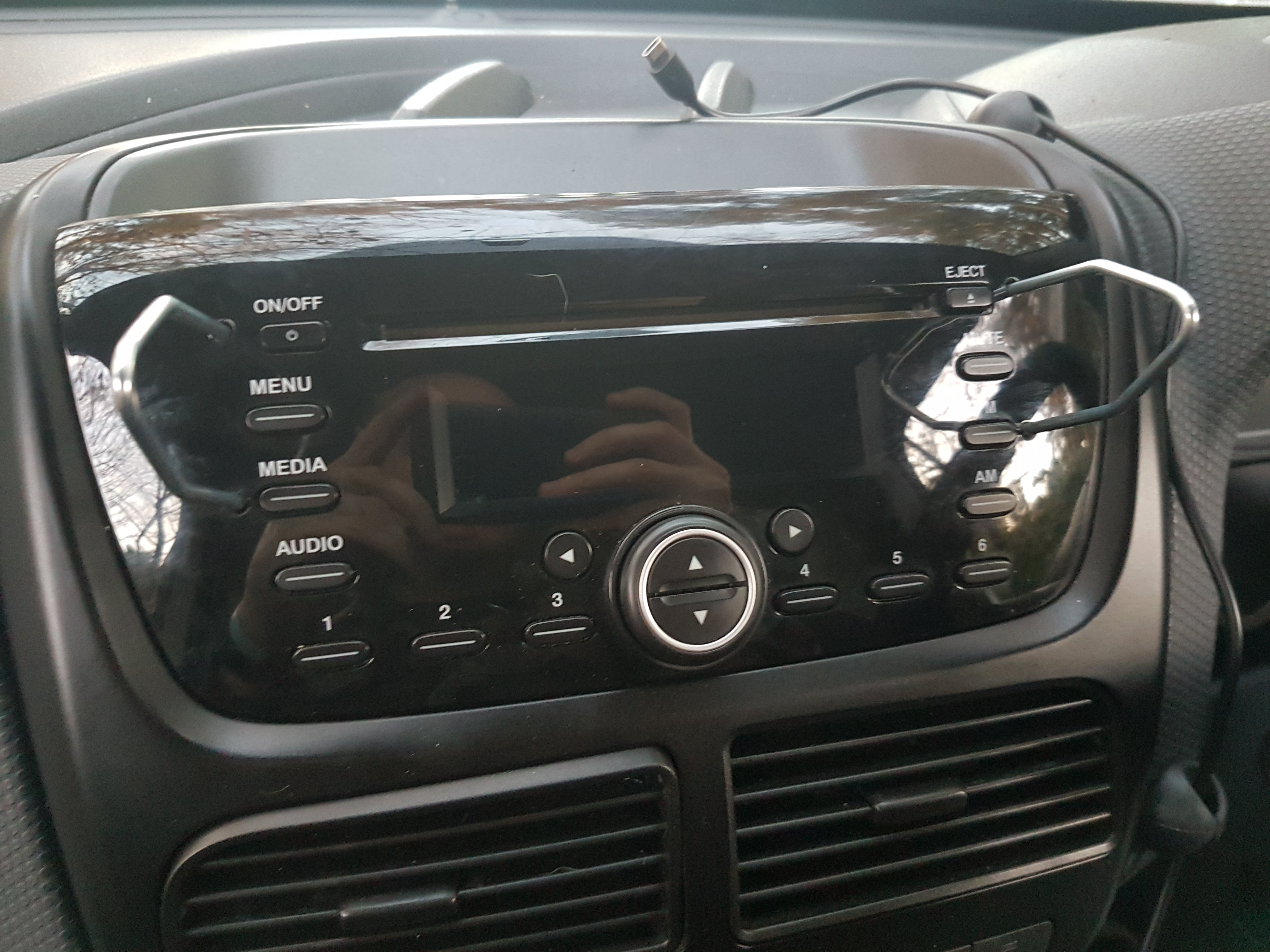

I can't for the life of me removed this stereo.
I'm using the right keys.
I'm pull then out so left key left right key right. And it just won't budge.
Anyone had similar issues? I'm sure someone has as the audio in the doblo is awful.
If you've managed it how far in did you put the keys and any special techniques? Not had any issues with previous cars
Quick update. Managed to remove. Had to invite a couple of flat heads to the party and prize it out.
