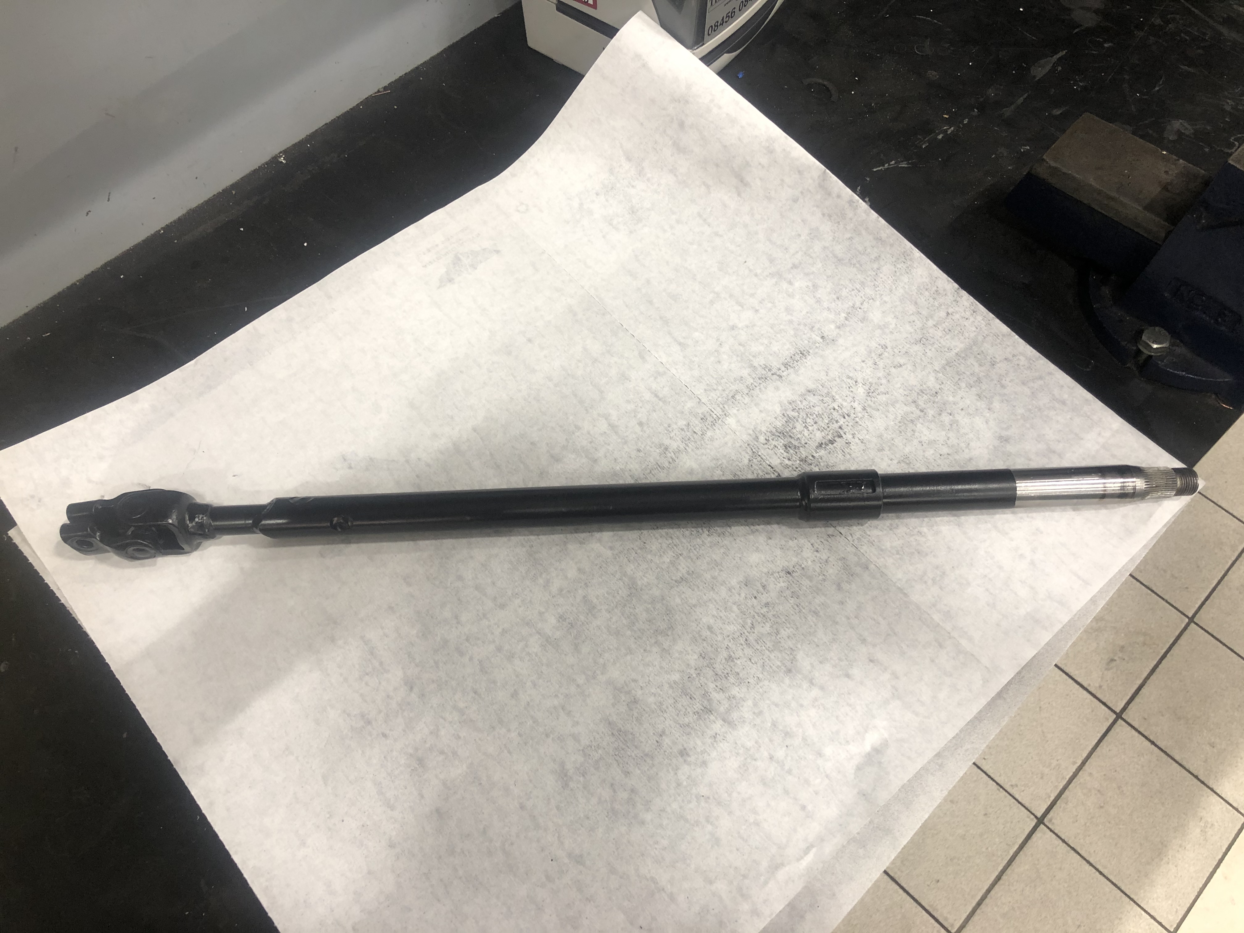

Thanks for the advise, I’ve taken a stab in the dark I’ve ordered a used 126 steering column and going to see if I could use spline from that and get it welded onto mine, I’ll let you know how I get on.... finger crossed
Hi guys I managed to repair the column by cut the spline off and welding a 126 spline, works a treat no more play
