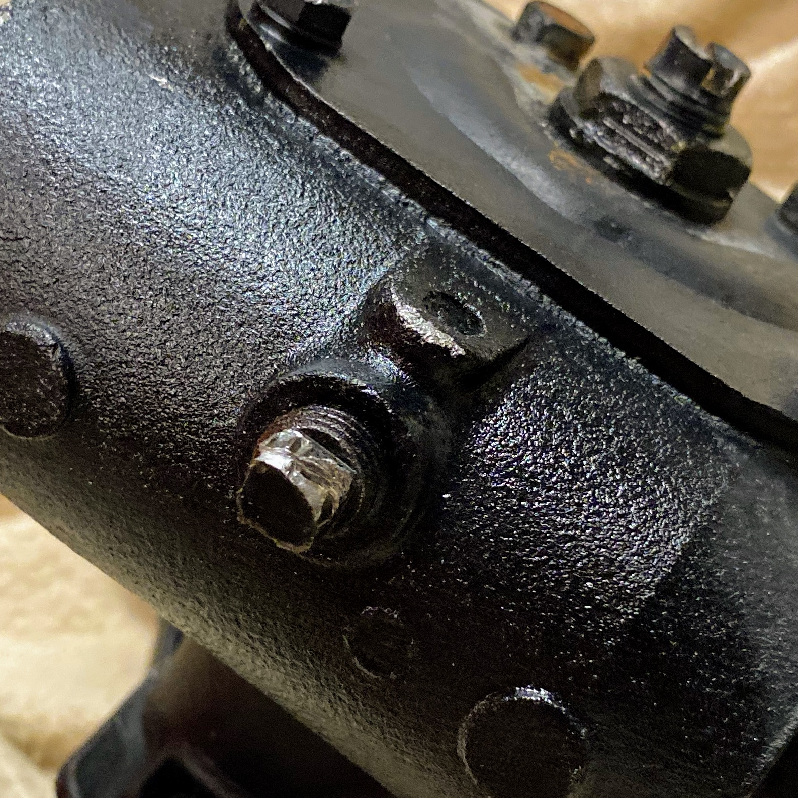

So I’ve got the steering box off for a rebuild, but cannot, for the life of me, get the drain/fill plug out. I’ve already slightly rounded the stupid square head. What a terrible design. Anyone have any tricks for getting this thing out? I’m afraid to round it more and just based on looks, am hesitant to try and easy out. Heat perhaps.
Otherwise, I might have to fill it by removing the top cover or some such.
Ideas? Thanks!

Try heating the plug and allowing it to cool. And put release oil on when hot.
Tighten the plug in a vice and move the casing to tighten and loosen the plug.
Basically you are changing the focus.

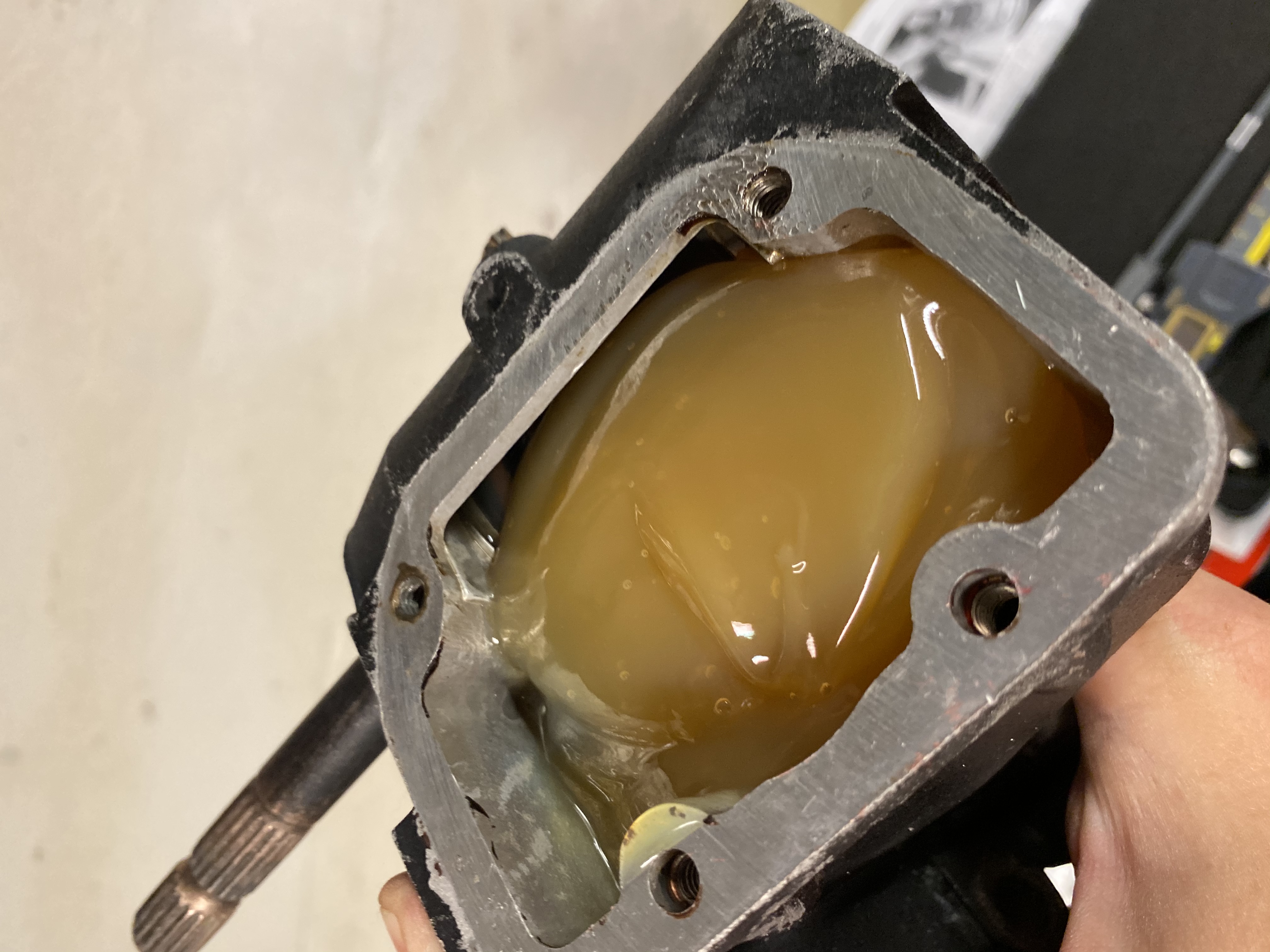

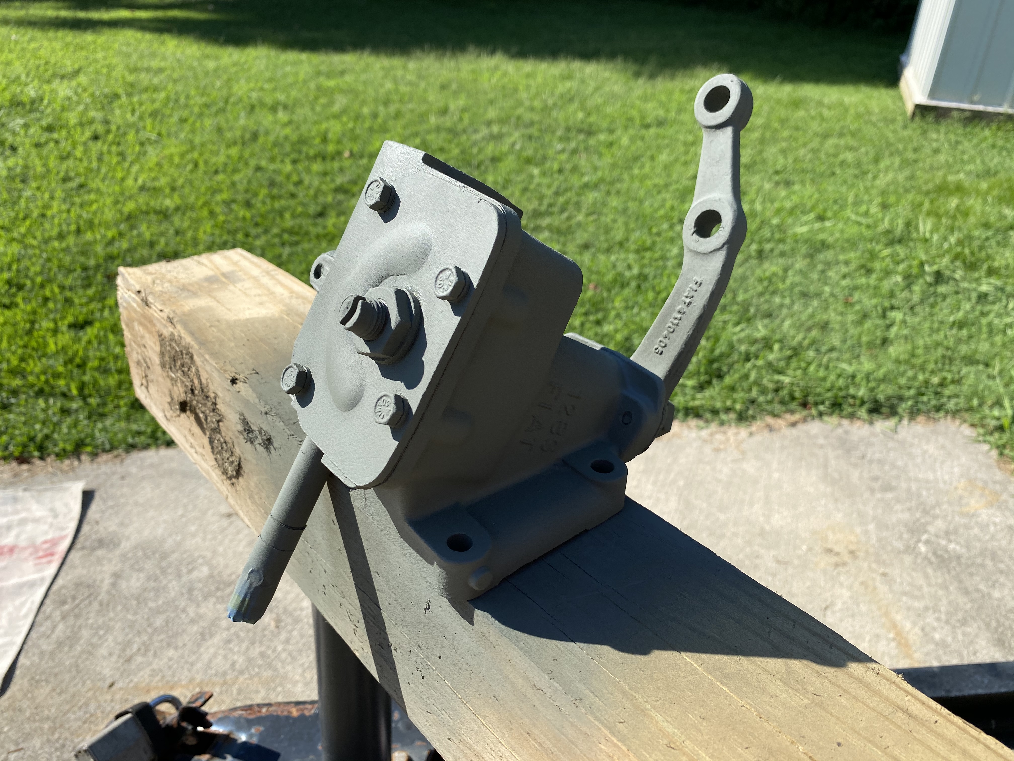

I tried the heat and generous applications of Aerokroil, but no dice. Rather than wait a few days to figure a machine shop solution, I just filled it through the top cover prior to buttoning it back up. With new seals, gaskets, and some thick steering box lube by Penrite, I don’t think I’ll need to be doing this again anytime soon. It’s primed and will get a top coat tomorrow.
