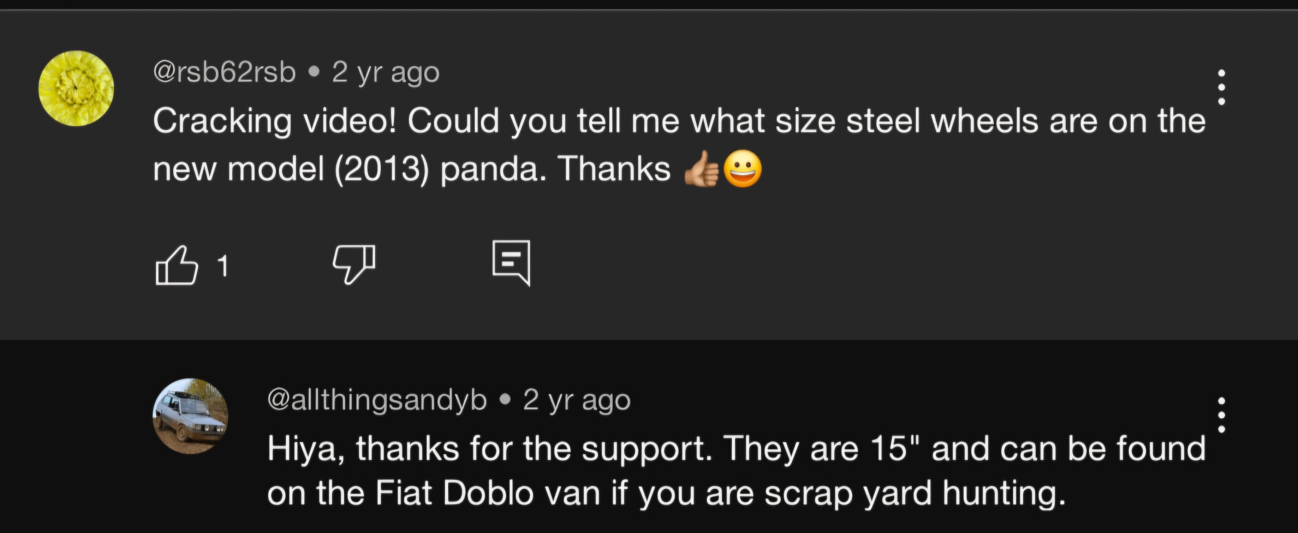

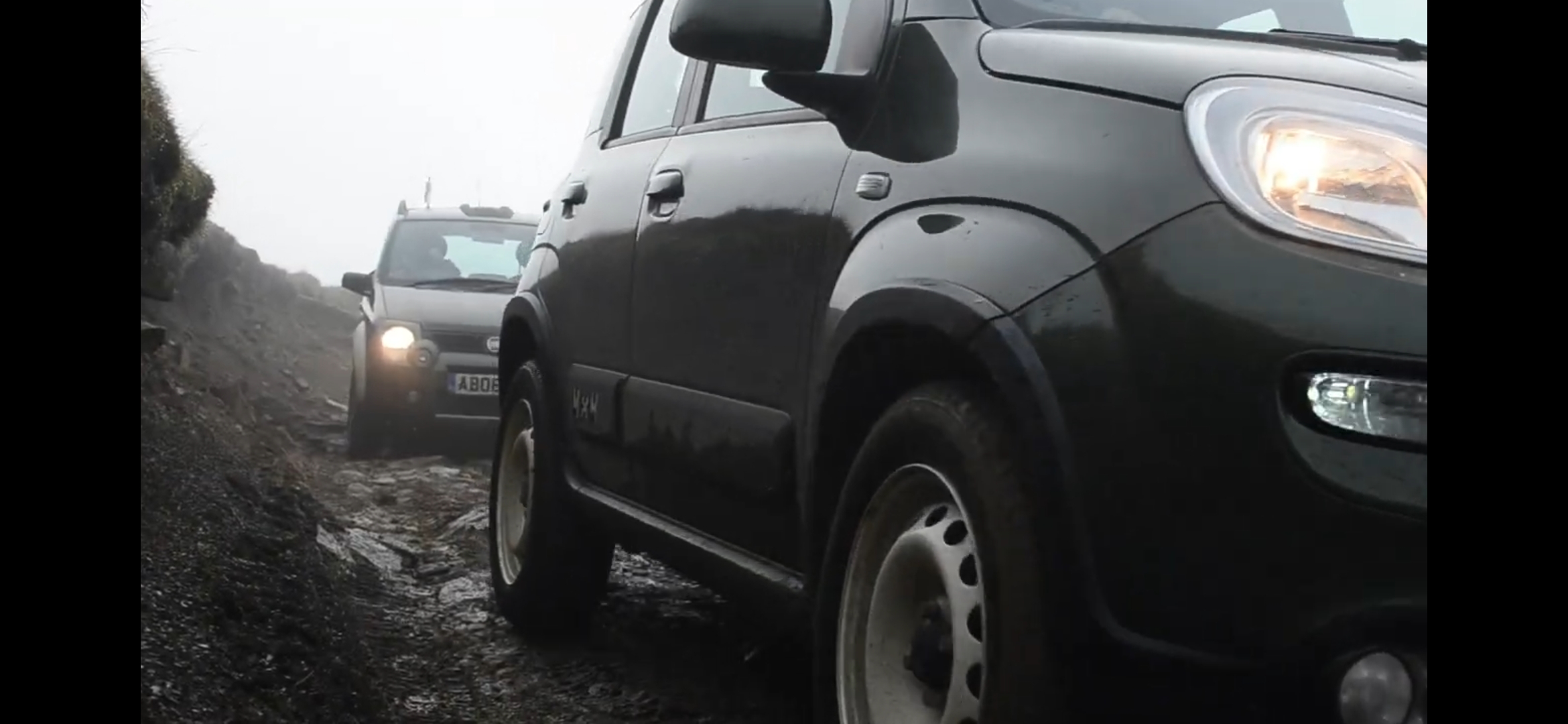

I've seen a 4x4 on larger white-painted steels on Youtube, looked pretty smart.... seems they came from a Doblo
Maybe older Doblos, all mine 2010 on, are five hole fixing.

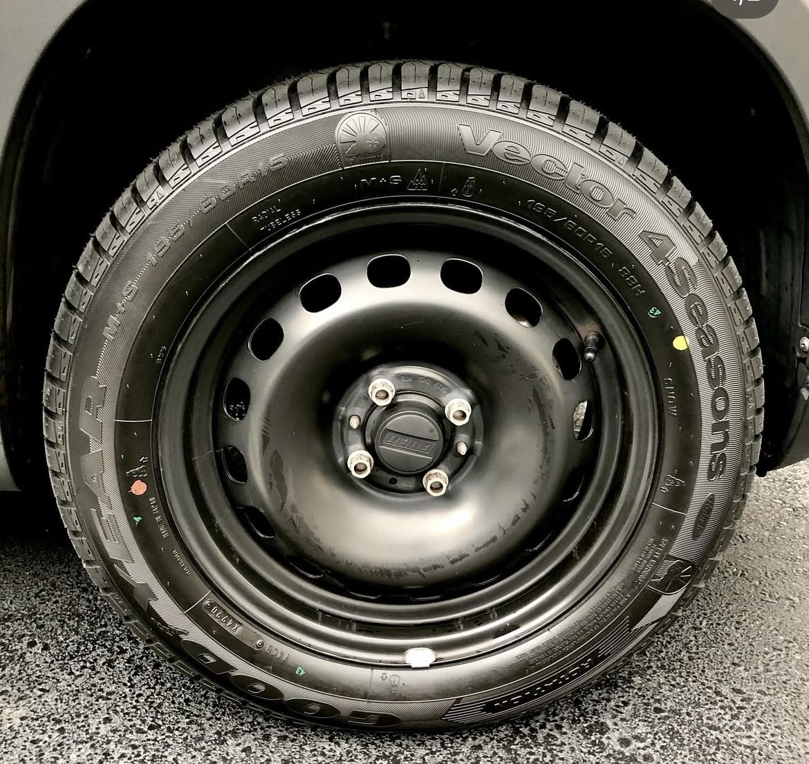

Many of the more recent ‘special editions’ of the 4x4 (eg the Waze model and the 40th anniversary version) have steel wheels but with a plastic cover to make them look like alloy.
These appear to be the same multi-hole steel wheels as in the video (from a 500 or earlier Punto - the later Punto used a different wheel bolt spacing)
And these, the ones used on the most recent 4x4 versions: (this will open the item but wants you to confirm the fitting…)
