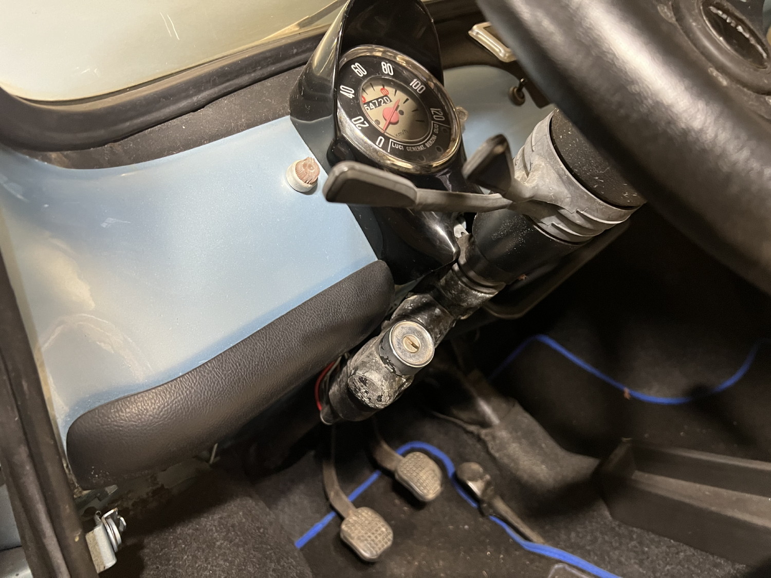

My Fiat with the starting problems has this ignition set up. Is this a typical later production F model ignition switch?
The dash style ignition switch is easy to remove. But I can't figure out how to remove this column mounted switch.
There are no detents for screws and the polished metal cover doesn't unscrew.
Should I try and slide the rubber boot down on the bottom end, then pull the wire connectors apart?
I would like to avoid pulling the steering wheel and sliding the whole arm up off the column.

Re the ignition switch in photo I suspect once battery disconnected and the plastic cover removed the switch it's self is held in place like the old 1970s Ladas I used to work on with a large wire circlip that you flick out with a small flat screwdriver hence the need to disconnect the battery to prevent it all shorting electrically;), you just need to get yourself upside to to get a good view of the back of the switch.
If it is that type they are available, although most seem to be the Lada Russian version rather than a better quality Fiat one, just take note and make sure the wires go back in original positions:).
Depending on condition as @fiat500 mentions it may be possible to service it, though on the Ladas the high current going through the switch was melting the plastic cams that moved the contacts causing the burning at the contract points due to a less than positive connection.
The steering lock it's self is mounted differently to the Ladas, they were clamped to the steering column in roughly the same position using snap off head bolts and I have undone many of them on customers nearly new cars using nothing more than a screwdriver, a small centre punch and hammer, tapping the headless bolt around until loose enough, the odd tight one I would hacksaw a slot in to make it easier to remove.
Yours in the photo, however looks more of a challenge, I suspect after wire brushing off you may find some "blind pins" at the barrel end holding it on, possibly needing drilling out, then the key would have to be in a certain position to release the lock barrel, hopefully your lock works OK
We did generally find the steering lock problem was caused by customers having poor pattern spare keys cut and the rough edges not been cleaned up on the wire wheel, so sharp bits dropped into the lock barrel with the usual consequences.
To this day if I have a locksmith cut a key for me I insist they do the wire brushing bit, though many say it is not necessary until I suggest they pull the teeth across their hand a few times, it can be like a saw blade!
Yours having the steering lock may have been to comply with import and insurance regulations in certain areas.

I took the plunge and tried to remove the thick form fitted rubber booty covering the wire connectors but it wouldn't budge so I cut it off and found that all of my leads looked clean and intact...which meant I was going to have to dig into the key switch itself:mad::mad::mad:

After hemming and hawing for the next day and looked it over again from a different angle and found the black lead had slipped off the blade connector. I pushed it back on and ...if fired right up! Thank god, because I could see no way of removing the key assy without having to drill out a pin or something, which meant I would probably have to pull the entire column just to get at it. Thanks everyone for your input. Now I need to sort out my non-working horn. Unfortunately the former owner installed an aftermarket one that works on a single power lead and a ground instead if the factory 2 lead. I'll post more details in a new post.
This ignition switch appears to be a similar one to the Ladas I worked on though with less contacts. They are just held in with a wire spring clip which with battery disconnected, clip removed with a thin screwdriver they just pop out, so easy to inspect for damage as long as you locate the key slot in original position and ensure wire clip safely back in place so nothing shorts against terminals.:)
