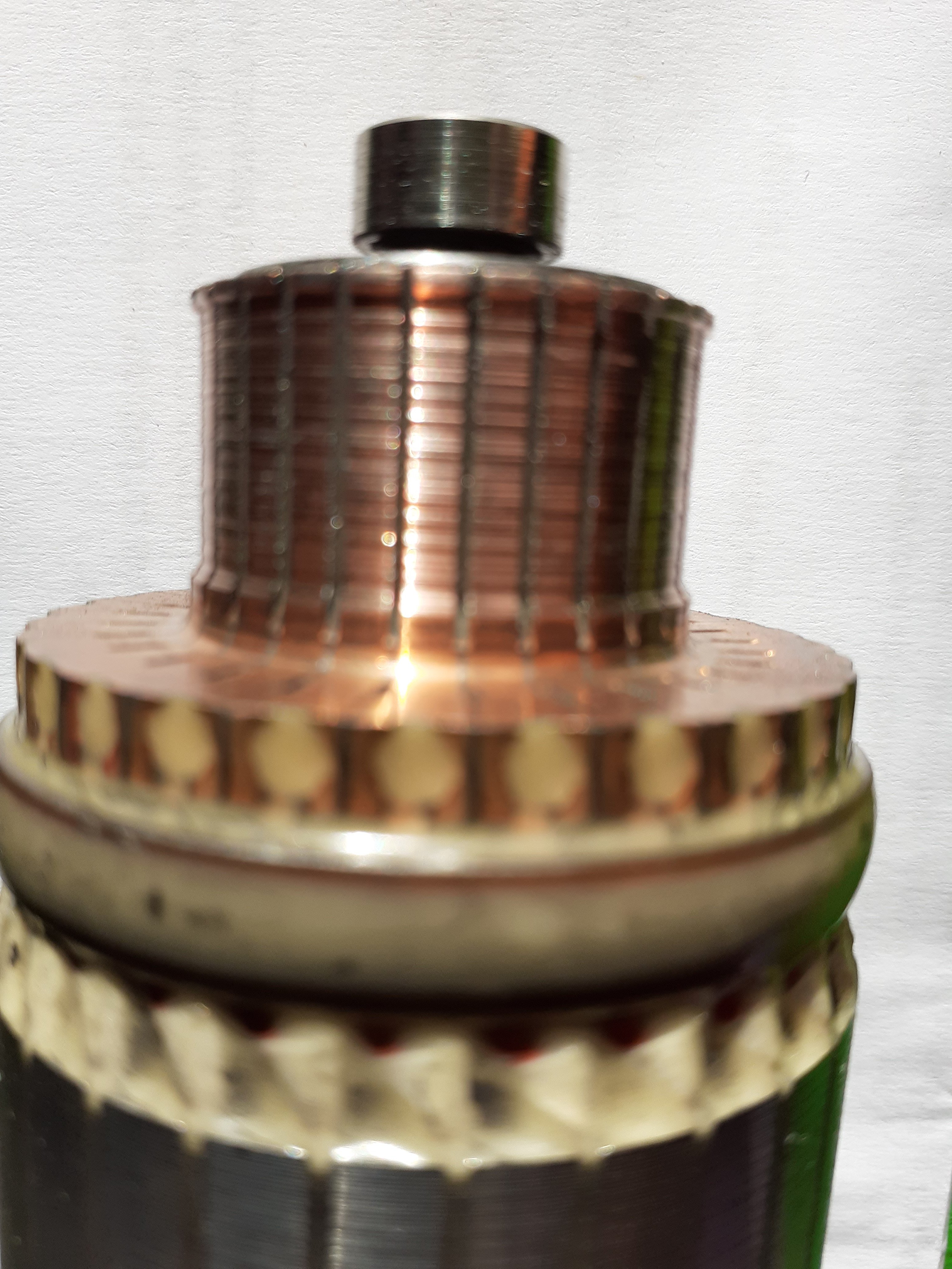

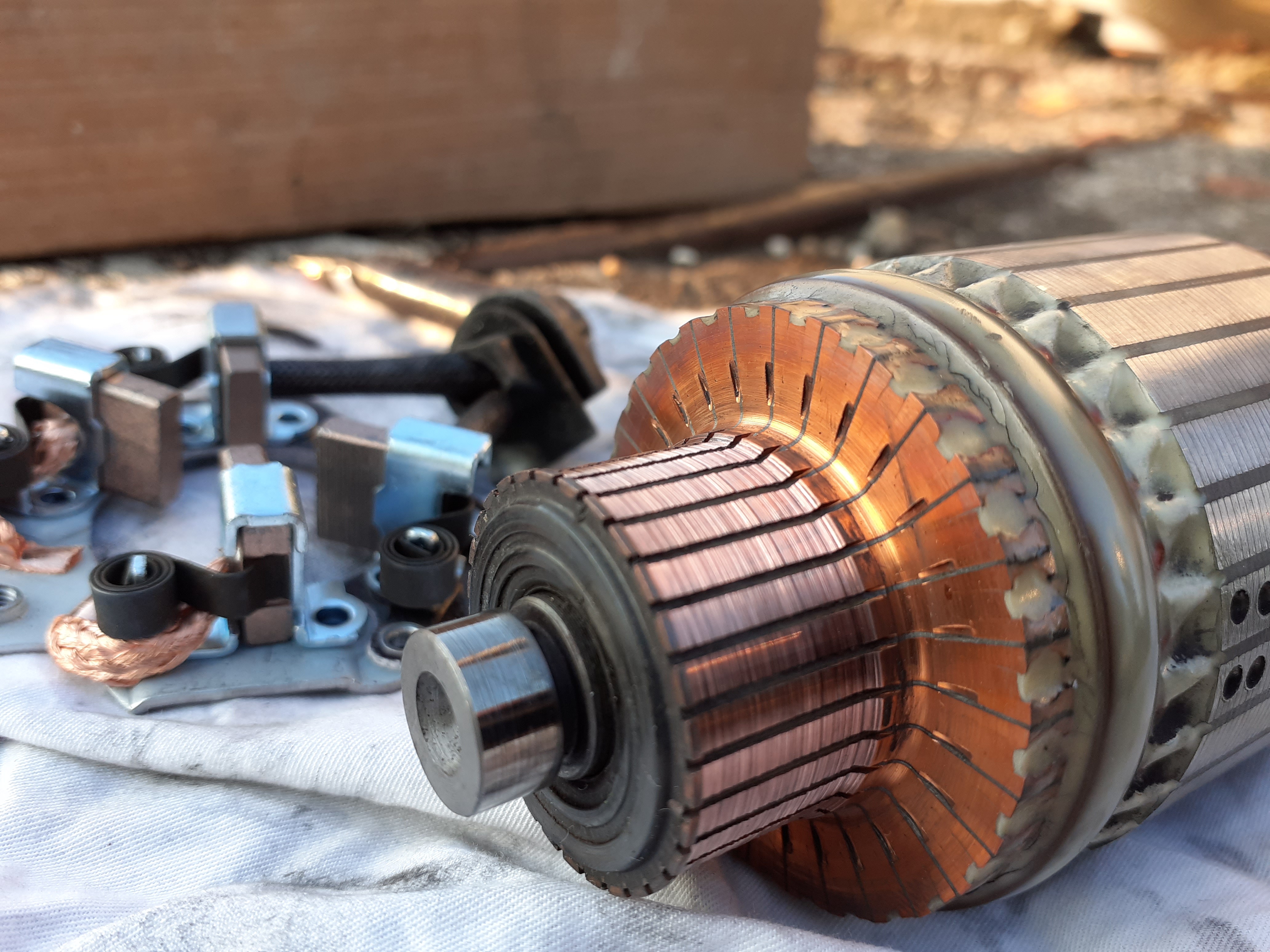

The higher than usual drop of voltage was caused by the very bad state of the starter armatures's collector.

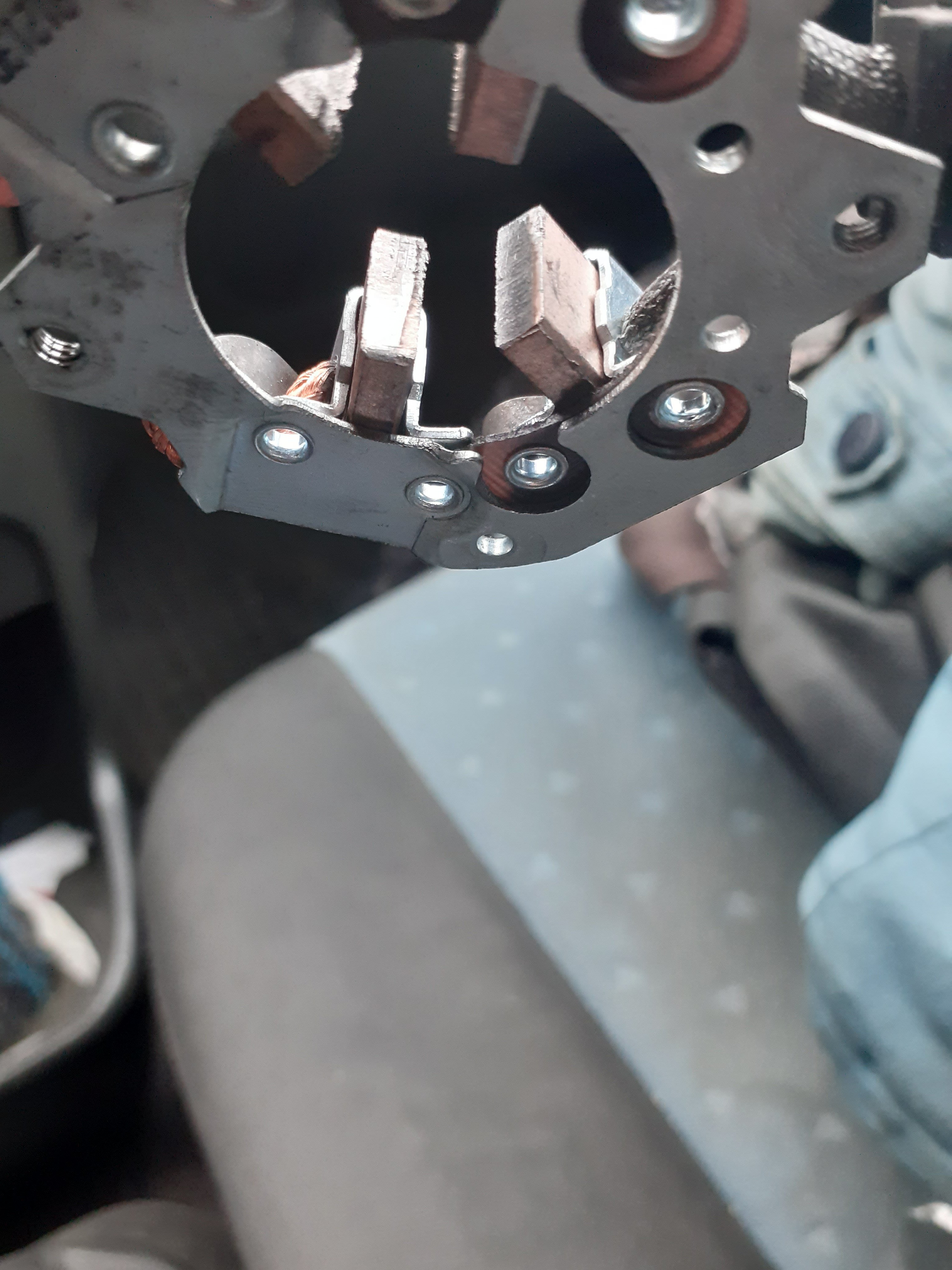

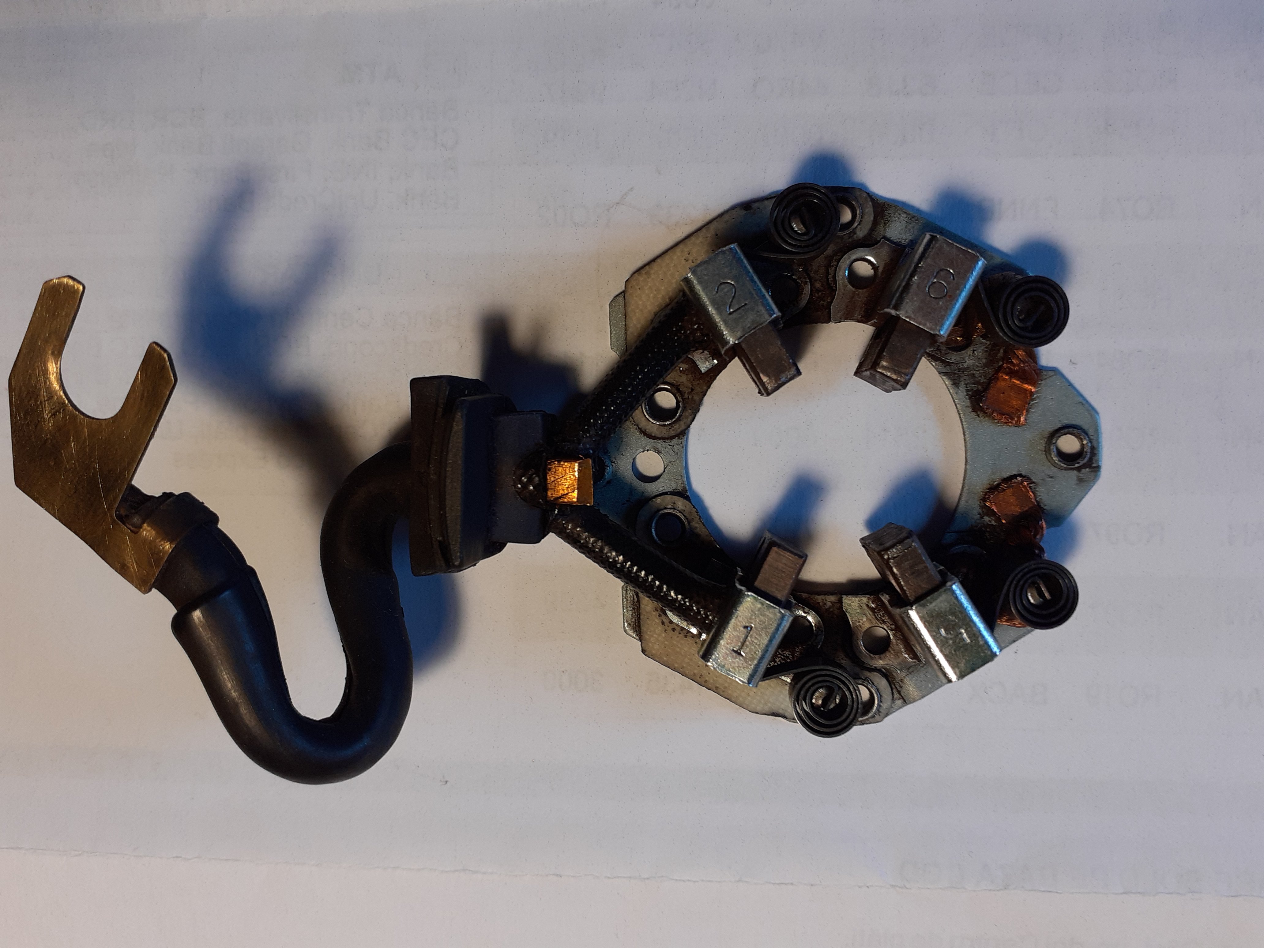

Here's a picture of it. And another pic with my old brushes, they are in good shape. And in the 3rd pic, I think I've spotted what the problem is with the new brushes: 2 of them, one (+) and one (-) on the same side, did not make contact with all their surface on the collector. I think that little piece on the edge, not touching was giving me the problem only on the first start of engine in the morning.
