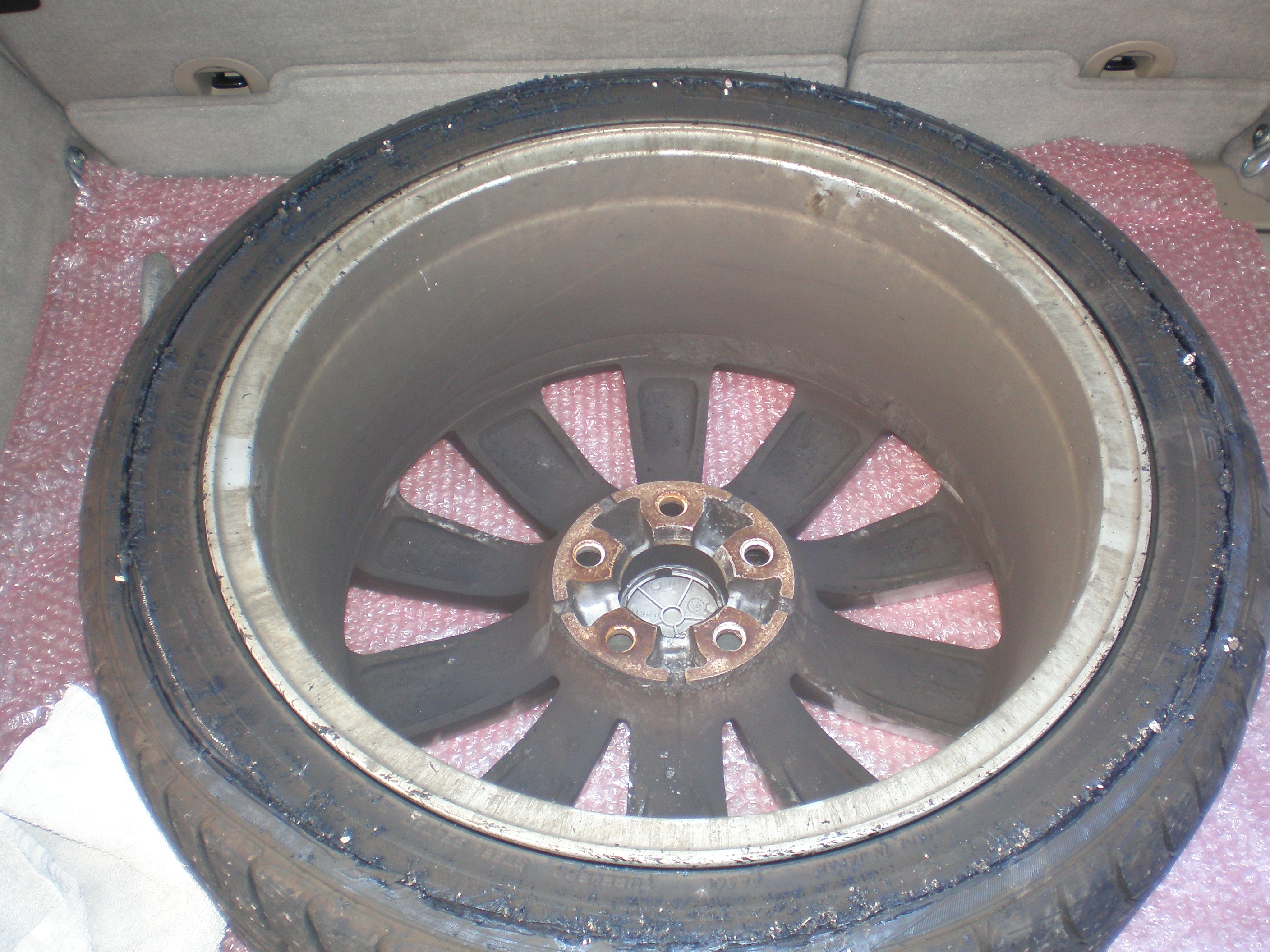

My front driver spring went while driving on the m4 @ 70mph causing majors shock to me and my family, what was left of the spring that had come out and cut clean my new tyre all the way round, manged to control my car ,I had the car towed back home and then I took down to the dealer , conclusion I had two set of front suspension , new tyre and some plastic s replaced , the dealer has said that FIAT Uk to pickup the costs ! I had the car back today after a week due to parts not avail in UK.
FIAT Uk have not done a recall until someone dies first ! Same happen for Stilo some one lost a life then FIAT did a recall.
This is a serious saftey issue I'm wirting to customer service manager , to trading standards and done to my local MP. I'm considering tomorrow to contact the newspaper I sure that way FIAT will start the recall !
Keep safe, act now ! Write to FIAT !

have a look at my tyre !

Hi
Very sorry to read of the spring failure of your car and well done for maintaining control. Unfortunately, this problem is affecting many makes and models of car. The number of breakdowns, attended by AA Patrols, which were caused by coil spring failure, has increased by 1000 per cent. We have been researching the issue, but it only seems to be a problem in some countries - such as UK and Germany.
That'll be the state of the roads, coupled with the increase in cars fitted with very low profile tyres...if the tyres don't take as much of the shock it's got to go somewhere. Just to reinforce aatekkie's point, my colleague has just had a spring break on his VW passat but thankfully it was when the car was stationary and unoccupied!

Yes there's a problem with the Stilo springs indeed!
Fiat did a recall for this problem not so long ago, but they didn't replace the spring, but put some "cage" around the bottom, to prevent a broken spring to puncture the tire......
Go to any Fiat dealer and have your VIN number checked for the recall.
If you want to do it good, go for another brand spring, f.i. Eibach or H+R, they will lower the car, but the quality of those springs is much better than Fiat original.
