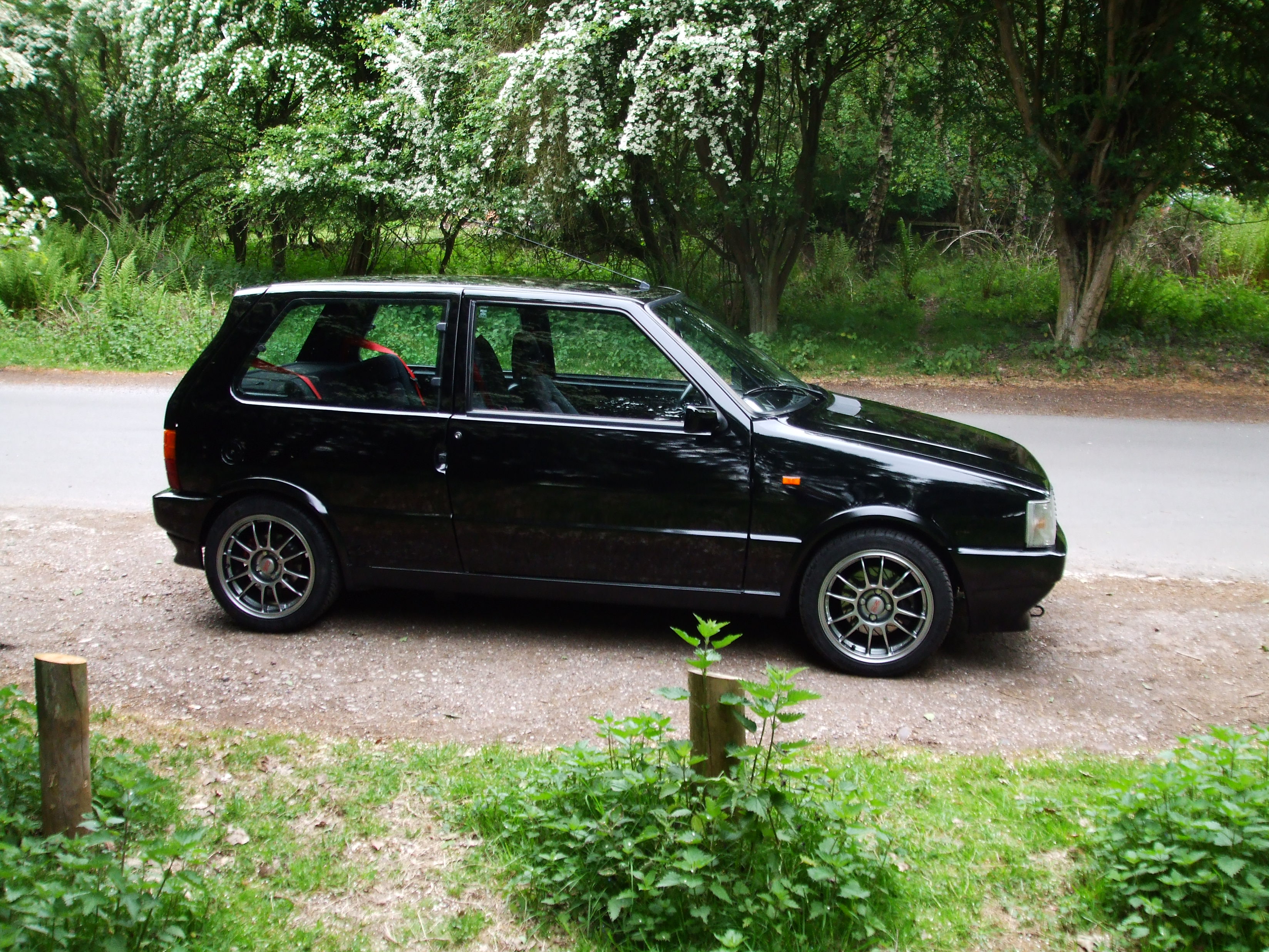

i have apex -40mm springs and dampers on my uno t and i'm happy with that,
tyre size depends on what wheels you have i've 195/45/15 on some lightweight oz super leggeras,
i would only use wheel spacers if you need to get wheels to fit as it adds weight mine are fitted without spacers. there 15" and 7j wide

that setup looks beautiful, mine will be in black or white..thanks for information Biggaitch
