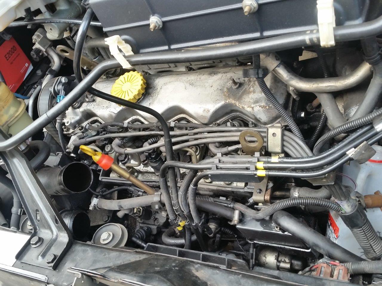

Hi Tom,
I have a little bit more time now, and I am attaching a photo of a 2.8 JTD engine. This photo was kindly provided by forum member IceVovo in a PM, and has the intercooler pipes removed.
Close to the lower RHS corner of the photo there is a cuboid plastic box (oil vapour separator) with a smooth surfaced pipe leading almost to the corner, and connecting with the air inlet hose, post filter. The oil vapour heater is teed into the smooth pipe, with the connector facing downwards.
